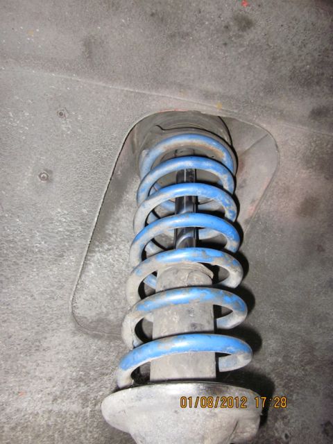

My 1972 recently developed steering wheel shake, its way of telling me its time to work on the front suspension. Since it's going to be dissembled anyway, I've decided to: 1) replace all the bushings and: 2) replace the struts.
There is, of course, a possible complication. I sure hope not, but I'm pretty sure the coils aren't stock.
The attached photo is from the left front suspension. There is no compression on the spring when unweighted. It turns easily in the holders, though it won't quite rotate 360 degrees. Maybe it would if I tried harder, but that seems like a pointless exercise.;) I'm not quite sure how to count the turns, the spring continues at the bottom and ends within an inch of where the top of the spring can be seen to end. I counted this as 7 turns, starting with the hidden turn "zero" at the bottom. The spacing is consistent except at the top and bottom where the spacing is tighter so that the a reasonably level coil end is produced. I measured 10 and 3/4 inches from top of the spring to the bottom of the spring (which is just about where the top of the date-stamp is). The wire is 1/2 inch in diameter. I haven't seen any markings but I haven't had it off the car yet. The ride does _not_ seem to be lowered. It looks stock and ground to body measurements seem right in line with what expected distances based on the tire diameter. Probably rides stiff -- I haven't ridden in any other Z so I couldn't say for sure, but my 150 lbs doesn't seem to make the slightest impression on it when pressing down on the fender.
The first question is about the bushings: rubber (stockish) or urethane? I understand that the urethane bushings are stiffer and more durable, what I don't have a grasp on is how the stiffness will affect ride and handling. Well, handling should be a bit crisper, but what about the ride and noise levels? I don't race it but it does get a lot of use, 15,000 miles / year is not out of the question. Would the stiffer urethane bushings be something that would be noticeable at all times or only when driven hard or on, for instance, rough roads, of which we are becoming increasingly well supplied with here in California?
The second question is what brand of strut. I don't need adjustable struts, so it seems to come down to KYB or Tokico. Prices seem pretty consistent regardless of source, I'll use Black Dragon's prices here: $60.00 for the KYB and $90.00 for the Tokico's. What am I getting for the additional 50% over the KYB price? I wouldn't mind spending more if I got a smoother ride _and_ better handling characteristics but I'd have to think about it quite a bit if the Tokico's only either rode smoother or handled better but not both. And I'd certainly like to hear about other options, though at $220 I do think I'll pass on the Koni's.
First, will stiffer than stock shocks make urethane bushings intolerable for regular street use, or make little difference?
Second, will the non-stock coils mean I have to use a non-240Z strut? I have no idea what kind of strut is in use now.

Your springs are after market for sure. It is likely a typical "lowering spring" designed to lower the car about 1 inch. The rest looks stock so you should be able to use any replacement strut made for the 240Z. The bumps stop seems to be missing so make sure to get new ones and install them when you change the struts. It makes a big difference in the smoothness when the suspension bottoms.
We have Tokico Blue struts and lowering springs on our car along with poly bushings. The Tokico Blue struts are only slightly more expensive than run of the mill struts from the auto part store but handle better (IMO). Poly bushings do add some harshness and noise compared to the original rubber parts. The ride in town is OK by my standards. The main thing I don't like is the gear noise from the differential is louder with the poly bushings in the mustache bar. Keep the original rubber bushings for the mustache bar if this will bother you.
The poly bushings need to be greased at install and probably should get serviced periodically. Since you plan to drive your car a lot you might want to go with the rubber bushings to ease maintenance issues. Unfortunately, Nissan never sold the bushings separately. Part stores might have replacement bushings however.

Thanks for the advice, I would not have known I was missing bump stops. And very much for the link. After posting I gave a run at figuring out the spring rate on those bad boys.
I bought a cheap household scale ($9.99, thank you K-Mart!), removed the wheel from the other side, taped a cardboard scale with 1 inch of compression measured off to the top of the coil, put a floor lift under the car and lifted him up. I slid the scale under the tire and slowly lowered the car until the spring had compressed one inch and noted the weight. 305 pounds! Stock is around 90 - 100 lbs and my first thought was that this couldn't be right. I thought that maybe the sway bar and compression rod were exerting a downward pressure as well, so I removed the former and disconnected the latter and repeated the measurement. 270 lbs. I removed the wheel, slipped a small bottle jack under the strut end and used the jack to lift the wheel assembly up the inch. 275 lbs. I haven't disconnected the steering knuckle, but since it isn't designed to control up and down motion while the sway bar is, to some extent, I don't think it can be having much of an effect on the measurement.
Here is where the link to Beta Motorsports proved very interesting. In the description of the Tokco HP shocks (I assume these are the "blues" you have on your car) they call them great shocks for springs up to 200 lbs / inch. Yikes!
The Tokcio HTS shocks, at $180 a shot are the only one of the three types listed for springs over 250 lbs. being rated for 200 to 375 lbs.
The doubts I had about my lbs. / inch measurement methods have been relieved by finding these statements. Rates of 270 lbs / inch aren't out of the realm of possibility and are, in fact, right around the midpoint for race-equipped early Zs. The relief I have in not being completely nuts is someone nullified by thinking that the Tokico HPs might not be a good fit for my car. Is this mismatch between recommended spring rates and my actual rates something to be concerned about or am I worrying too much about something that would have, at most, a small effect that I may never experience?
Although at a little under $100 for the pair, picking up a new set of progressive Tokcio springs with 140 lb rate might not be the worst idea in the world.
Hmmmm.. Thoughts?

Your spring rate measurement technique is wrong. To actually measure spring rate you first compress the spring one inch and then compress an additional inch and measure the rate for that second inch of compression. Also, you're not taking into account the suspension motion ratio, the angle of the strut, and the stock bind/friction in the inner LCA bushing. The stock bushing does not turn, it flexes so you have the hysteresis of the rubber adding to your measured spring rate. The front motion ratio is either .97 or .98, I don't remember which. Cheap bathroom scales get more inaccurate as the weight goes up so figure a 5% variance on that. Basically the 270/275 number is meaningless.
One way to check your measuring process is to jack up that corner (with the car level to begin with) until the spring stops compressing and the chassis starts to rise. That should happen around 650 lbs (if you scale goes that high). At that point measure the compression of the spring. EDIT: you don't need to measure the weight with this check. Just measure total compression of the spring and then divide 650 by the number of inches of compression and you should be able to come close.

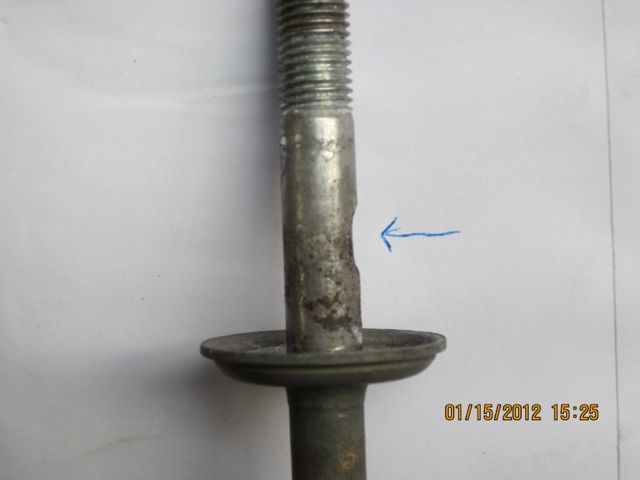

Both of the sway bar bushing mounts were split clear through. There may be another equally large problem with the sway bar assemblage.
QUESTION: (See attachment Sway Bar Strut).
Not sure of this thing's name, "Rod Connection Assembly" is from the on-line parts catalog, but this is one of the two rods/ struts that connect the sway bar to the control arm. They looked symmetrical to me, so I didn't make note of which side connected to the sway bar and which side to the control arm. It was only later when degreasing did I discover this notch / indentation (there is one on the other rod/strut as well, but not quite as large.). The notch/indent only appeared on one side of the strut. I don't think it was designed with a notch, which brings up the question, is this something to be concerned about?
