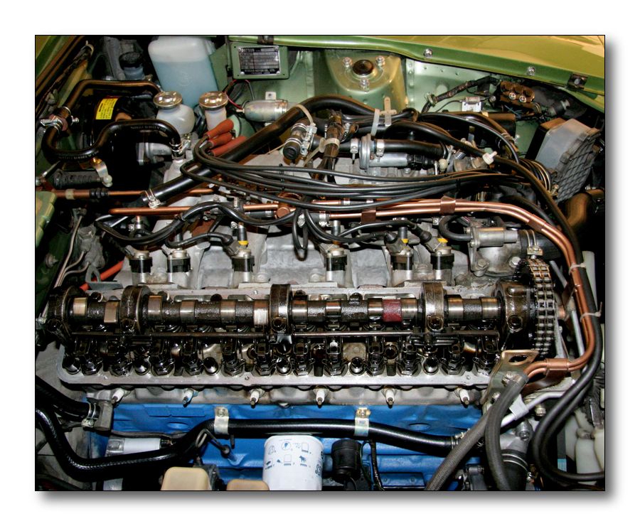

mgood, Thanks for the pic. So assuming both cars are stock, then they changed somewhere between 76 and 77.
I've been on a spray bar kick lately, and the small tube on yours that sprays the two rearmost lobes looks like it's angled inwards toward the cam. If that's the case, then the bar probably isn't sealing well against the rear journal. You might want to give it a good going over to make sure everything is OK. I recently completely reconstructed mine on my 74 because it was falling apart.
