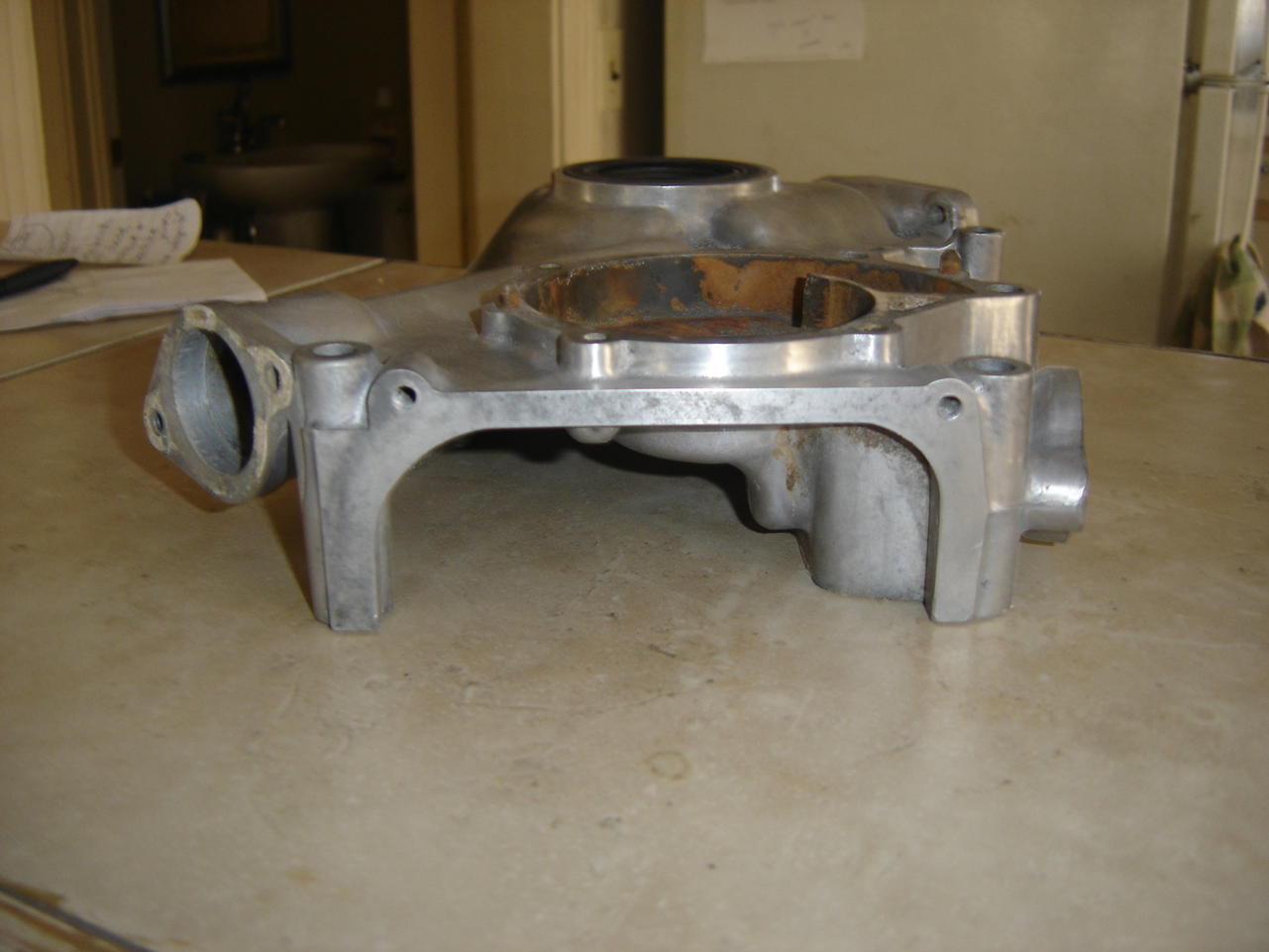

Tip wise, about the only thing I can add is don't forget the two small 6mm bolts that go vertically into the front cover through the two tabs at the front of the head. The one by the fuel pump is pretty obvious but its friend by the dizzy is hiding pretty good, especially if its caked with gunk. And don't forget to put them back in.

i dont suppose someone has pictures of these hiding ninja bolts?
