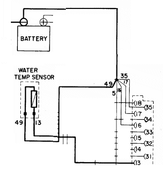

That's funny! Blue, I looked at EF-32 of my 77 FSM and am not really understanding what pin 49 is. I see other wires running into the same place as 49. Is this a common ground area for these wires? Ok I see it now! I pulled my wiring schematics that I had blown up several years ago so I could read them. Looks like 49 runs to one of the FI fusible links on the battery. But I'm still not sure if this is a connector or what. So do I check it the same way? What should I be looking for at pin 49? Thanks

Water Temp. Sensor
Ok, that shows you get 2.96kΩ at the sensor and at the ECU so your sensor and wiring are OK.

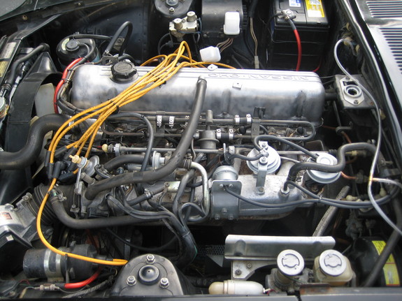

As you can see, the original routing is on the left and the modified is on the right. Gummy vented gases from the valve cover no longer got routed through the AAR after the mod. On some cars the T junction behind the AAR was capped but on others, the T was removed and a small metal pipe with rubber adapter was routed from the back of the AAR to the front boot hose. Like this:

OK, the pic with the yellow plug wires is how mine is set up. I will also double check TPS. When I checked last it was making contact at idle position. Blue, I'm going to give you another update that I just thought about while I was working on my brothers car. On start up (over night) she fires almost right away (cold start works). Idles at about 850 like the AAR is not working. But, if I raise the throttle to about 1500 for about 30 seconds and let it go it actually only drops to about 1300 and thats when the AAR is working. As if the AAR requires that help to get it working. But if I don't raise the throttle it never gets to that 1300 rpm and idles rough like not enough or too much fuel. not sure if this helped or made it more complicated.
