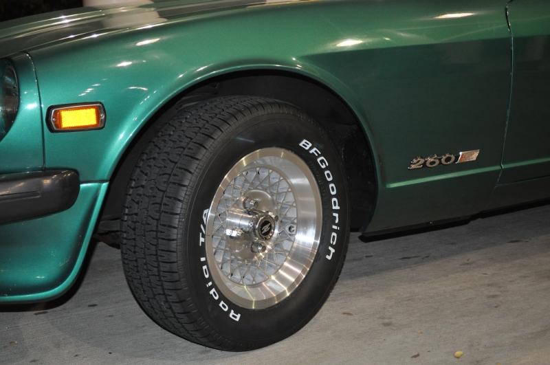

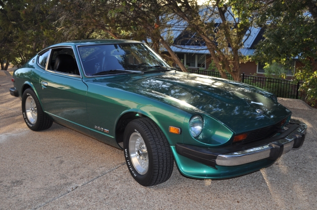

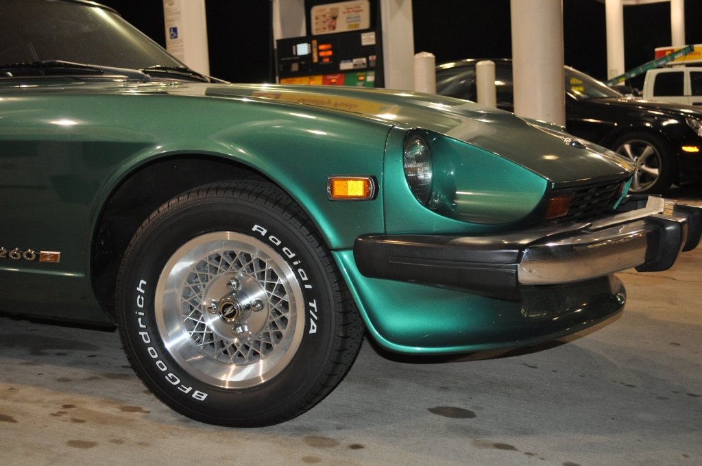

I run old 14 x 6.5 Appliance rims and just recently got new tires. Went through some of the same gyrations on tire sizes and ended up settling on 225 60 R14. Went with the same BF Goodrich tires you are considering and it all worked out really well.
My suspension is lowered by maybe one inch but otherwise is stock. As you can see from the attached pictures, there is plenty of clearance and I have no rubbing issues so far.
Hope this helps.
Mike.
