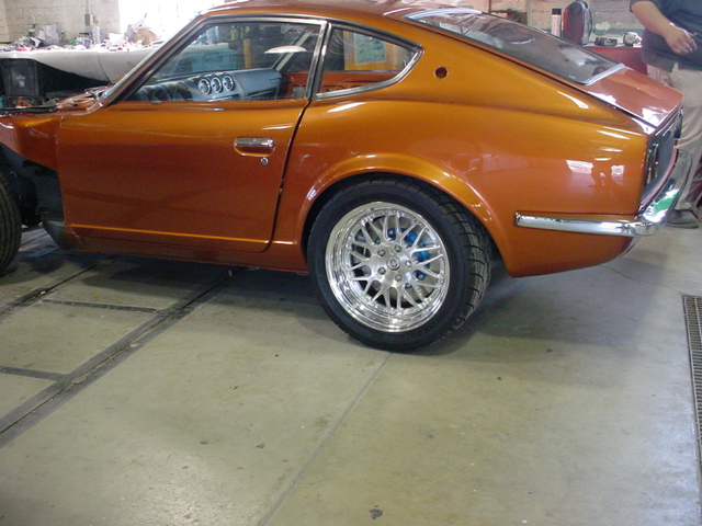

Are flares like this done by simply bending metal?
This pic is of a 260z I built for a customer a couple of years ago. The rear openings are flaired in metal. They required minimal welding and the opening edge is rolled . The tire size is 275-40 zr 17. You can check the
Picasa link at the bottom of my signature and go to Gregs Car for the build folder . I'm unsure if there are detailed in progress pics of the process.
I also like the subtle flares.
Larry- the work on that 260 is outstanding. I hope to see that one around some of the events/shows this year. I will be in need of a paint and body guy probably mid next year... and Chicago is just up the road from Indy. You just made the short list ;)
