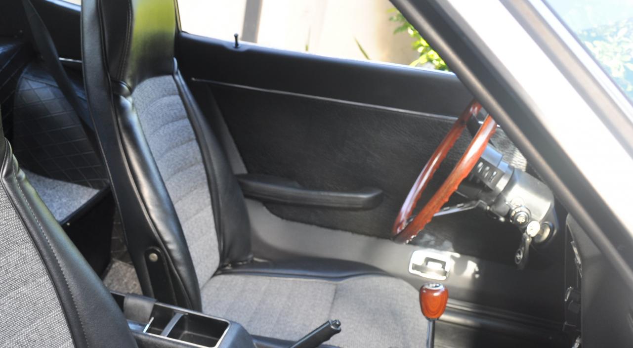

Oiluj Posted January 22, 2012 Share #3 Posted January 22, 2012 For the chrome strip, try a hobby store for Monokote adhesive trim in chrome silver. Pic isn't exactl what you want, but might help. Bottom-line, the chrome strips line-up if everything is properly assembled. Link to comment https://www.classiczcars.com/topic/42029-interior-pictures/#findComment-378411 Share on other sites More sharing options...
Captain Obvious Posted January 22, 2012 Share #4 Posted January 22, 2012 Oiluj, Nice seats. Where did you get the seat covers? Link to comment https://www.classiczcars.com/topic/42029-interior-pictures/#findComment-378422 Share on other sites More sharing options...
Oiluj Posted January 22, 2012 Share #5 Posted January 22, 2012 I basically copied interior I did years ago in my previous Z. Seats are custom. Vinyl side panels with upholstery cloth center inserts. The center fabric is a dark grey/light tweed. I "think" name of the fabric was "Opal". I can look it up in my records if you like.Carpet is a charcoal loop I got from from Home Depot. Used old carpet as patterns and finished with sewn vinyl edging. Link to comment https://www.classiczcars.com/topic/42029-interior-pictures/#findComment-378456 Share on other sites More sharing options...

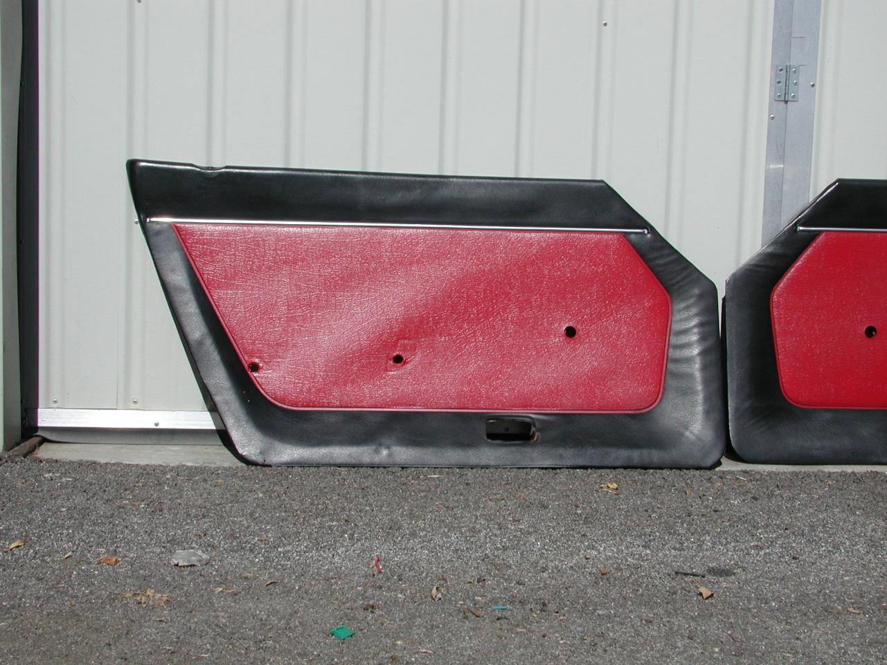

tlorber Posted February 15, 2012 Author Share #7 Posted February 15, 2012 I thought I'd post a follow up here. On a test panel, I tried 2 different silver rattle cans that I had at the shop. I also bought some chrome adhesive pinstriping, since I couldn't find any mylar at the hobby shop, and finally I bought some Duplicolor Instant Chrome. The pinstriping was definitely the most chrome looking, but I couldn't get it to stick to the tight curve of the plastic bead, so I ended up using the Duplicolor. While it is by no means mistakeable for chrome (i.e you will not be spraying it on a flat surface and then using it for shaving in the morning) it has a much higher reflectivity than either of the silver paints. I would say it has 70%-80% of the reflection/brilliance of chrome. The final door panel is shown below. Hope this helps someone else down the road. Link to comment https://www.classiczcars.com/topic/42029-interior-pictures/#findComment-380815 Share on other sites More sharing options...
mlc240z Posted February 15, 2012 Share #8 Posted February 15, 2012 I found some silver/aluminum duct sealing tape at Ace, applied and cut to size with an exacto knife. Definitely not chrome, more of a polished aluminum look but it is consistent and doesn't look toooo shabby. Better than the chrome with blue gaps. So far has worn well, and the roll was about $5 with plenty left over in case a redo is necessary in the future. Link to comment https://www.classiczcars.com/topic/42029-interior-pictures/#findComment-380840 Share on other sites More sharing options...
tlorber Posted February 16, 2012 Author Share #9 Posted February 16, 2012 (edited) I forgot to mention that I tried tape as well on the test panel. The problem I had with my tape is that the aluminum was so soft that when it got scraped (by fingernail) it left marks. Edited February 16, 2012 by tlorber Link to comment https://www.classiczcars.com/topic/42029-interior-pictures/#findComment-380885 Share on other sites More sharing options...

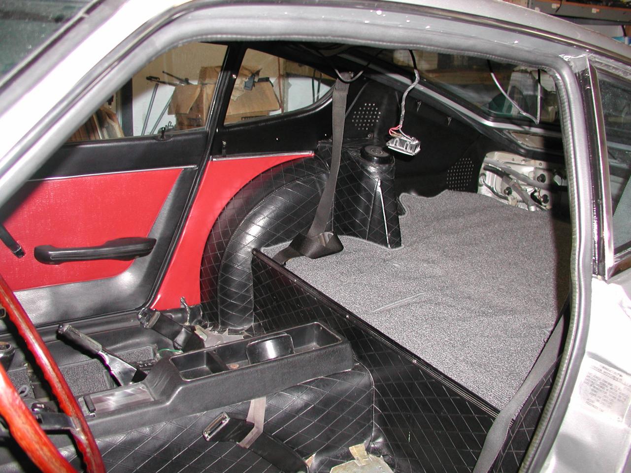

tlorber Posted February 28, 2012 Author Share #10 Posted February 28, 2012 Just thought I'd punctuate this thread with some final pics, (not meaning to respond to my own thread but I know we all love pictures;) Link to comment https://www.classiczcars.com/topic/42029-interior-pictures/#findComment-382436 Share on other sites More sharing options...
Oiluj Posted February 29, 2012 Share #11 Posted February 29, 2012 Looking nice. Can't wait to see the finished product! Link to comment https://www.classiczcars.com/topic/42029-interior-pictures/#findComment-382474 Share on other sites More sharing options...
Reverend Posted February 29, 2012 Share #12 Posted February 29, 2012 Thats uber cool, never thought that red would look that good on Z! I love your carpets too... Link to comment https://www.classiczcars.com/topic/42029-interior-pictures/#findComment-382503 Share on other sites More sharing options...
