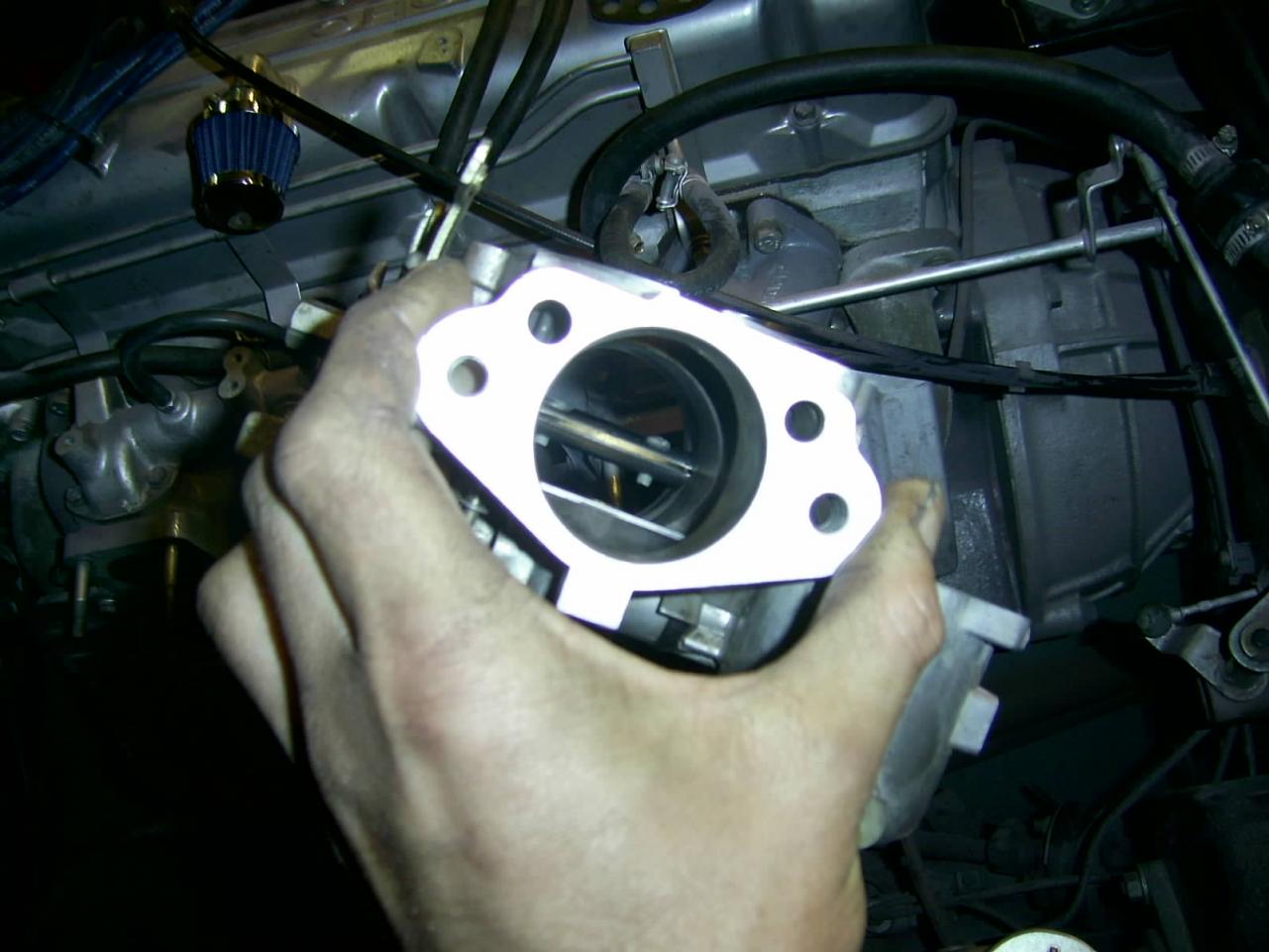

Making sure this is alright due to using parts from a 71 and a 72. I have a E36 intake manifold (believe this was from a 71), no water jacket going to carb.
Then I have the 72 insulators with the water jackets.
Going into the 72 SUs with water jackets.

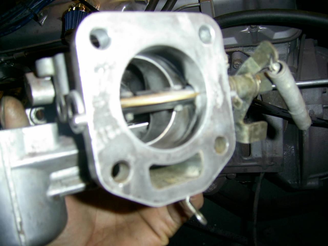

Ok, now for the air box side of the SU's, I have the 2 air ports at the top which I believe feed the damper.
But my air box only has the one opening for the air port.
Does this all seem compatible? I am currently not running the water line thru the intake, so I do not suppose there is an issue with the insulator but wondering if I should be using the earlier insulator with no holes. And for the air box only having one air port opening whereas I am just blocking off one of the air feed holes to the SU, not sure whats up with that and if I should drill that hole out or not.

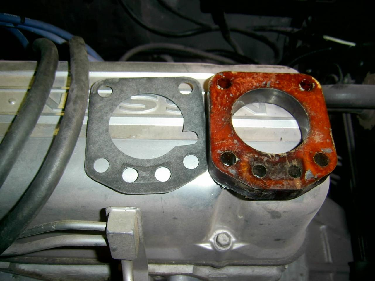

Does the backing plate only have one hole in it like the gasket?

The backing plate has 1 hole, the gasket has 2. Here is a little bit better picture from the other side.
Not really sure what year backing plate this came from and if I should have the 2 holes that feed thru to the carb dome.
You learn something every day..... or should. Just asked Steve the owner of Zed Therapy about the hole thing and he pawed through his pile and said almost all his backing plate have ONE hole, Every so often he'll see one with two but the second hole has been drilled. Roadsters and SSS setups all have both holes in the backing plates. I pride myself on having very limited knowledge on this subject because for several years getting us out of the aircleaner business was a primary goal of mine.
