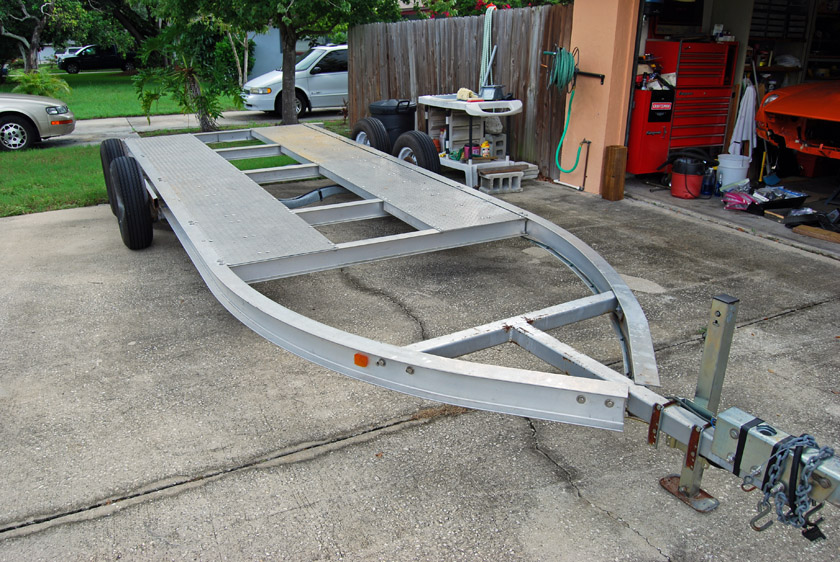

The trailer pictured - came up on CraigsList a few months ago - Someone had ordered a custom aluminum trailer for his Pantera in 07, but then the customer went bankrupt in the 08 crash before the trailer was done... The trailer manufacture went bankrupt the following year. The manufacturer had about $3000.00 at his cost - in labor and materials in the unfinished trailer ... and wanted to get something back out of it. So bought it mostly for a prototype platform for $1500.00.
It's all aluminum, torsion axles, surge disk brakes etc. It was intended to have a low load height. The entire exterior frame is 3.5"x5.5" aluminum "I" beam, the cross braces are 3"x5" "I" beams. It is presently 20' long point to tail - and was going to be a V-Nose. I may shorten it to 16' deck length + V nose. Deck is 82" outside of the frame to outside of the frame.
So in the next few months - I'll be talking to a few fabrication shops and a couple of manufacturers of big fiberglass boats in the area - to see what a custom enclosure would cost... I want to keep the weight under 1700 lbs - the axles are rated at 3,500 lbs each.

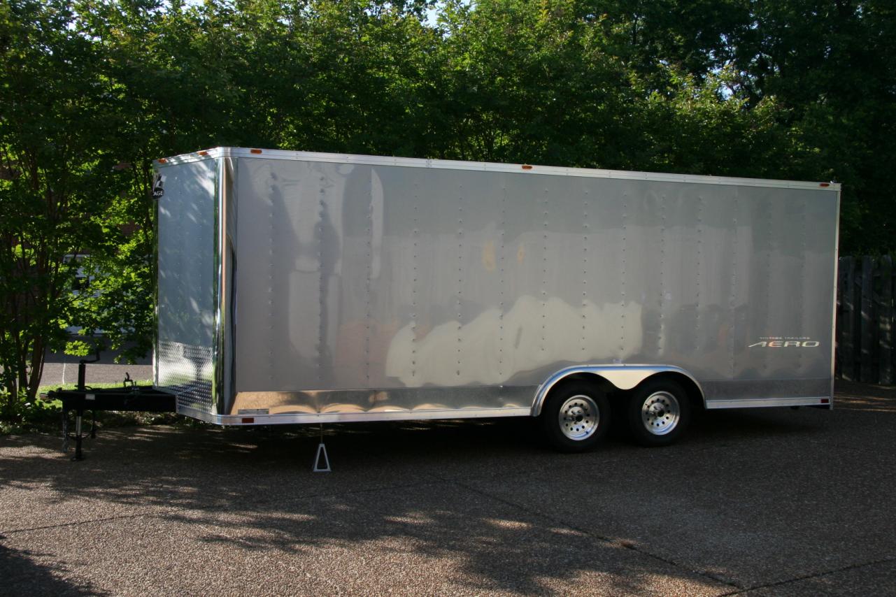

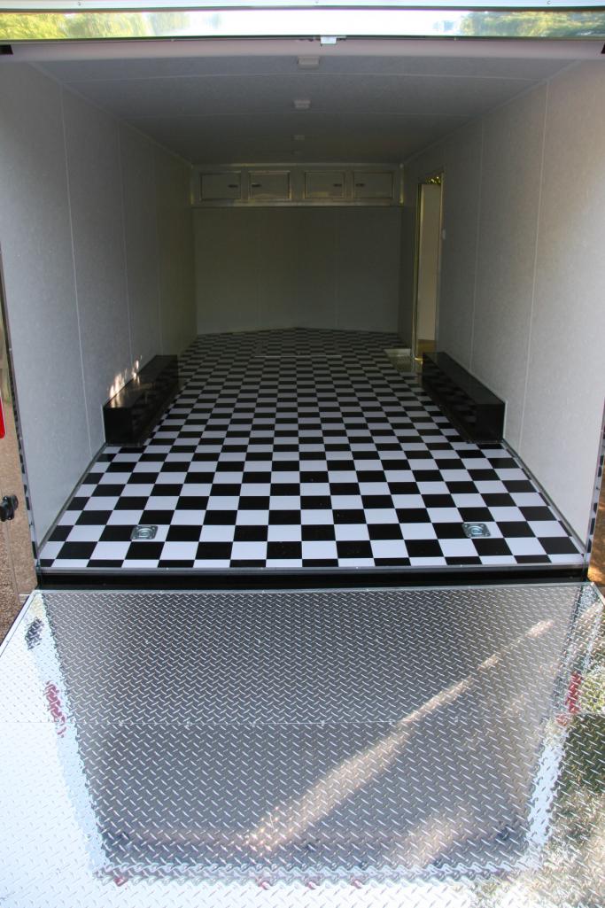

I have a 20' that was made by Vintage of which has plenty of room for either my 240Z or my 300ZX. I had an overhead cabinet installed which is great for storing chairs, straps etc. Here are a couple of shots for reference. If you have any questions about this model just let me know.
https://www.classiczcars.com/topic/42149-trailer-size/#findComment-379479
