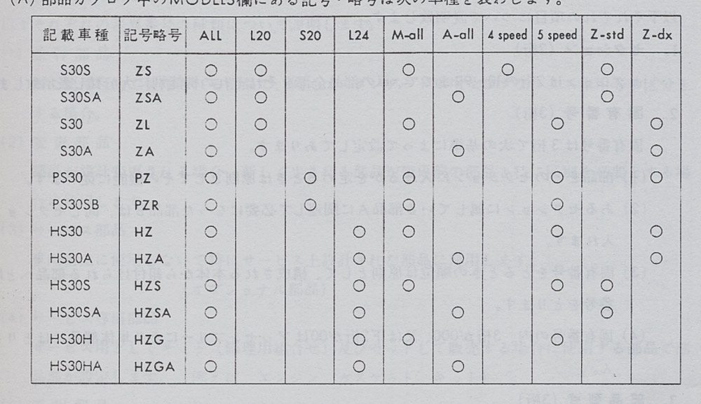

The VIN is S30-04679 which denotes a Japanese market, right-hand drive, L-20 engined Fairlady built around mid January to early February 1971. I attached a scan of 1971 model variants for the Japanese market (probably credt AlanT for the info). If the car has an original 5-speed, it is probably a Fairlady ZL model.
