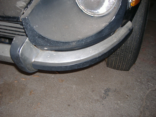

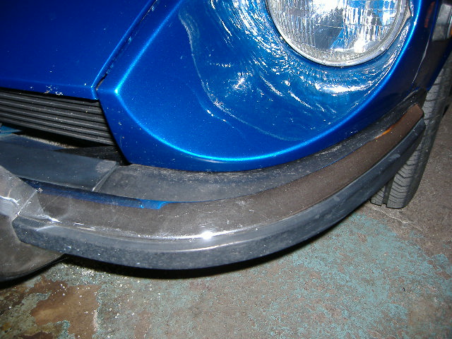

Blue is a 73, black is a 70. The over riders on the 70-72 will be in line with the hood line, the 73 over riders are set inward a few more inches. The 73 will use the large bumper brackets, 70-72 look like strap steel. The 73 bumper is a little larger in all directions to place the rubber inserts on the sides & a flat metal piece that fits between the two, it makes the 73 bumper stick out about 3-4 inches more.
Bonzi Lon
Thanks Bonzi It looks like I have a 73 bumper. Man its like brand new but I would have to buy all the extra parts and it wouldn't be the true bumper. Bummer. I would like to have teh 72 bumper. I guess I'll sell this one and look for teh original. What do you think?

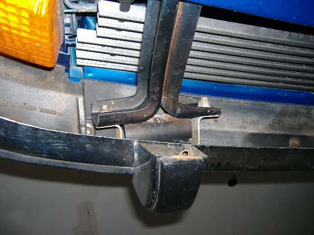

It is my understanding that the 73 bumper is a little larger in all ways, north, south, east, west, up & down. Now I wish I had removed, measured & compared the early 70 with the 73 bumper. One day soon Bryce (bluecrazy) and I will meet up, he has an early one, mine will be removed for replating, so maybe we can get exact measurements. The 73 over-riders are wider also. Photo #1 shows the larger bumper bracket & the wider mounting points.

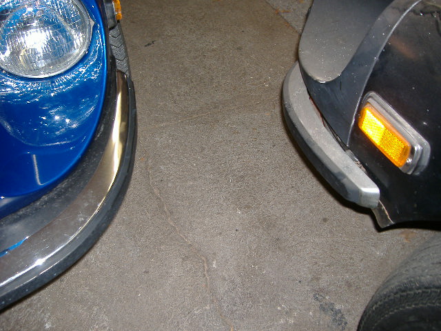

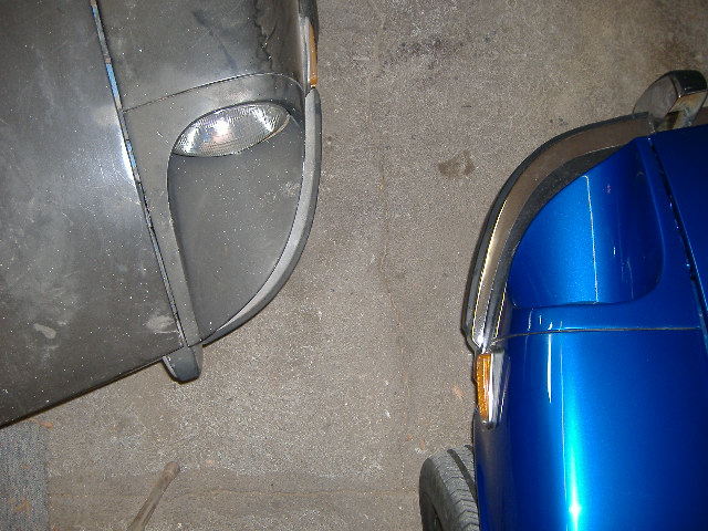

As Bonzi Lon stated, I just purchased a 72 bumper to replace my 73 bumper. When I get the 73 bumper off I will have to lay them together and see what all is different. Not sure when I will be getting to that, but I will update you after I get it off.
Bryce
  • 2 months later...
So....I happened to lay the 72 and 73 bumper together the other day. They are practically identical in size, and length. The mounts are very different, as everyone knows. The problem you would run into, if you were thinking about tucking in a 73, is the mounting studs. They stick out alot and it wouldn't look as good without the middle filler piece covering the mounting area. There isn't much room to tuck with the middle filler piece in place.
