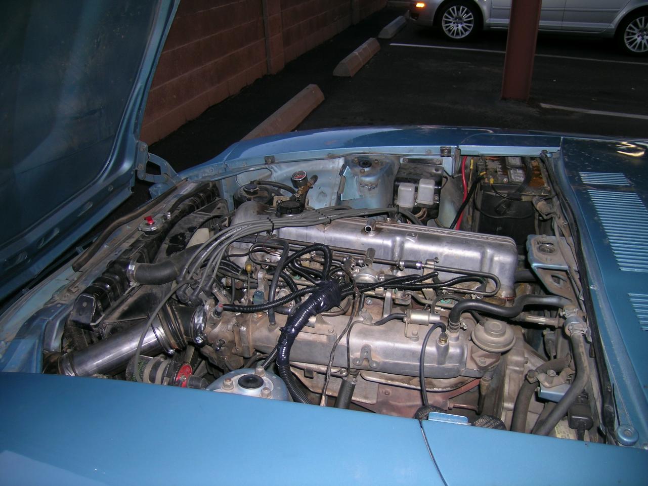

As everyone here as pointed out the stock EFI system is, well old and out of date. It was a great feature of the 70's but its just not up to par with everything out on the market. I recently did a megasquirt (MS) upgrade on my Z as my old EFI system was leaning out and stalling and I just wasn't going to deal with trying to fix it anymore. The install took about two days (roughly 14 hours or so but I was taking my time). The only warning I have is do your homework before getting it. The install is simple enough the tuning is where people have issues. MS can control pretty much everything on the engine from injectors to the timing, its just a matter of how far you want to go. I just have it controlling the injection for now. Here is how my engine bay looks now (its about 80% complete. I "tried" to make the wiring look stock like, it came out ok in my opinion).

So how does it run right now?....good?
Is that aimed at me? It runs amazing and that's not an understatement. I don't have dyno results but from the "feel of my seat" dyno I definitely have more power (or at least the power I'm supposed to have) at all RMPs. The throttle response is better and fuel economy is up a tad, though I think I have a case of lead foot now. :-).
