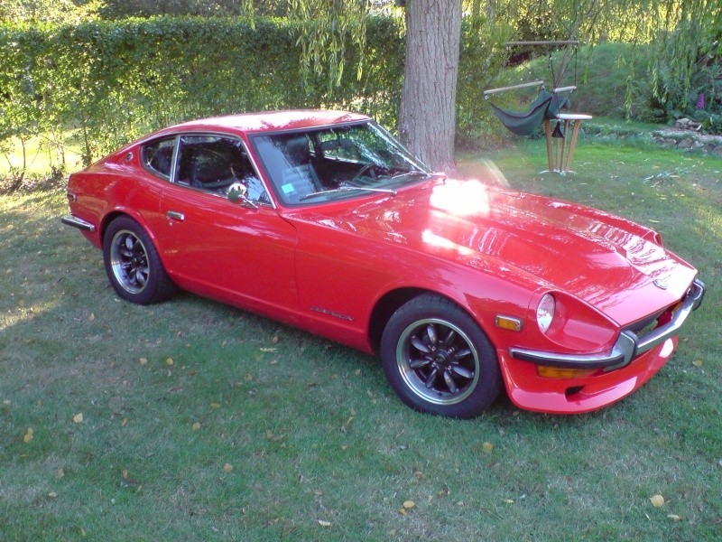

I've got 225/50/15 kuhmo ecsta's on both my cars and LOVE them. They are mounted on 15x7 inch wheels 0 offset. Best set up i've found so the above comments are very true. No rubbing, no fender trimming. I have found I roast clutches faster with this much meat on the ground.

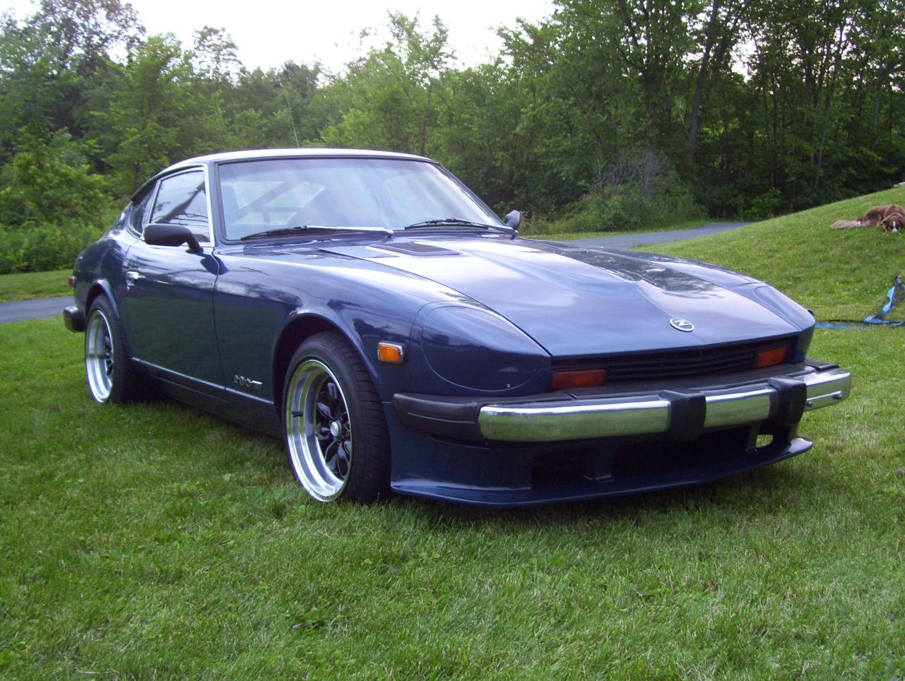

Keep in mind folks that the front body work you are running makes a huge difference in what size tire you can run. Lazeum's car looks awesome with that air dam on it, but I could never get away with a 225/50 on my stock valance with my car sitting on tokikos springs and struts. I rubbed with 205/60's, so I had to run 195/60's. (15x7 0 offset rim) I may be able to get away with 205/55's, but it will be crazy close.

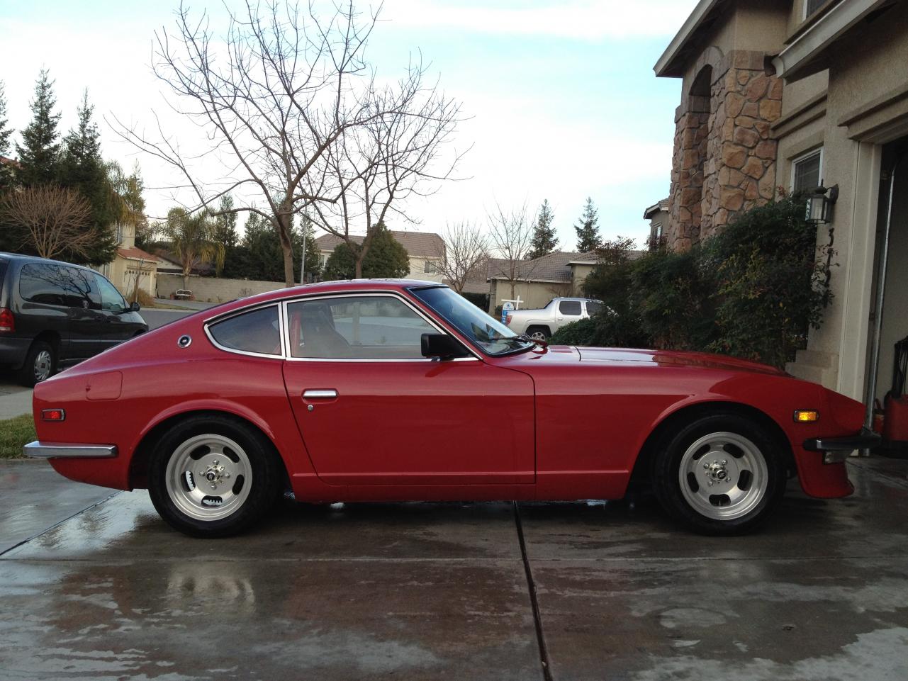

I've got XXR 16"x 8" with Sumitomo 205-50-16 0 off set no rubbing but the car is lowered.

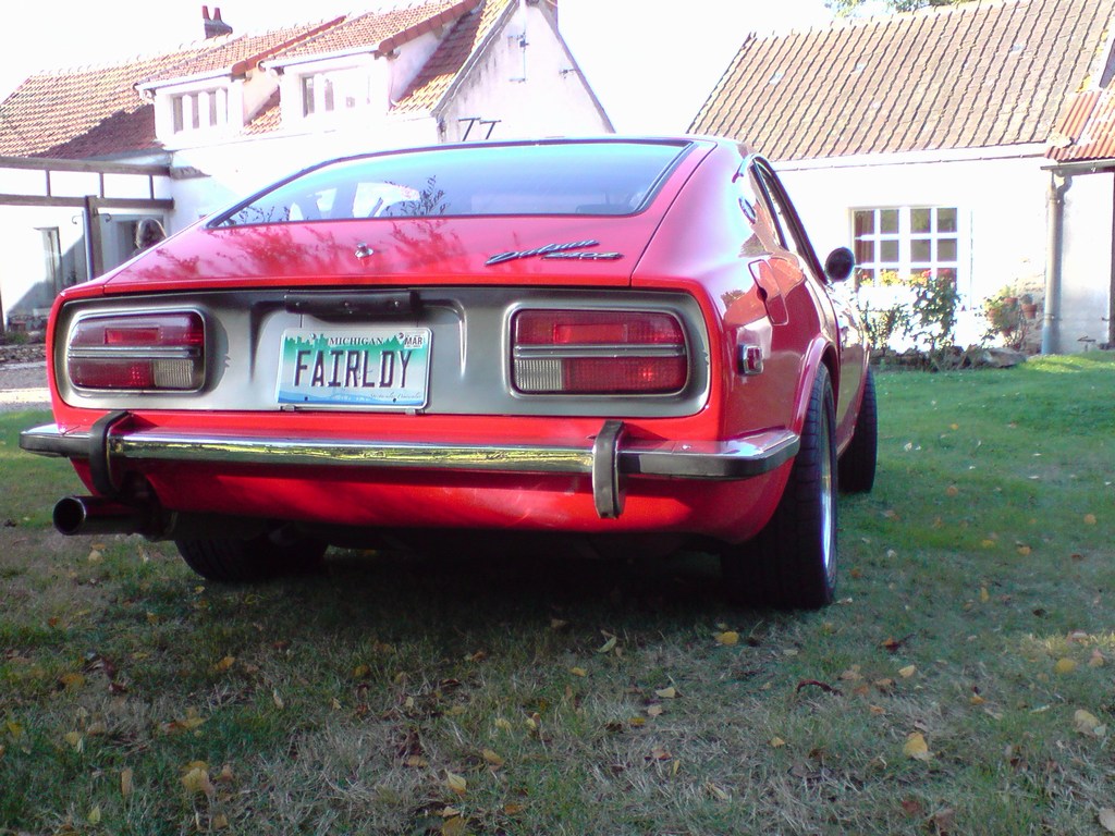

This is my setup, RB in 15x7 et+4 with BF Goodridge G-sport tires in 225/50. Setup is great with no rubbing.
Clearance with spring perch is 5-7mm.
Thanks! I've got the dam so shouldn't be a problem here. I may just splurge for Pana's:)...
Nice. Still some gap there even when lowered?
