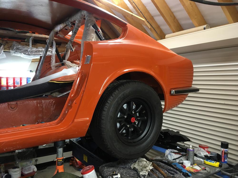

The worlds slowest car build has had some progress.
1st off, its off its wooden dolly, the one that was suppose to be for 3 months, lasted 6.5 years. I put it on the suspension mounting points so couldn't bolt anything to it.

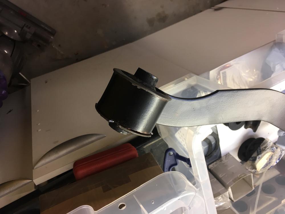

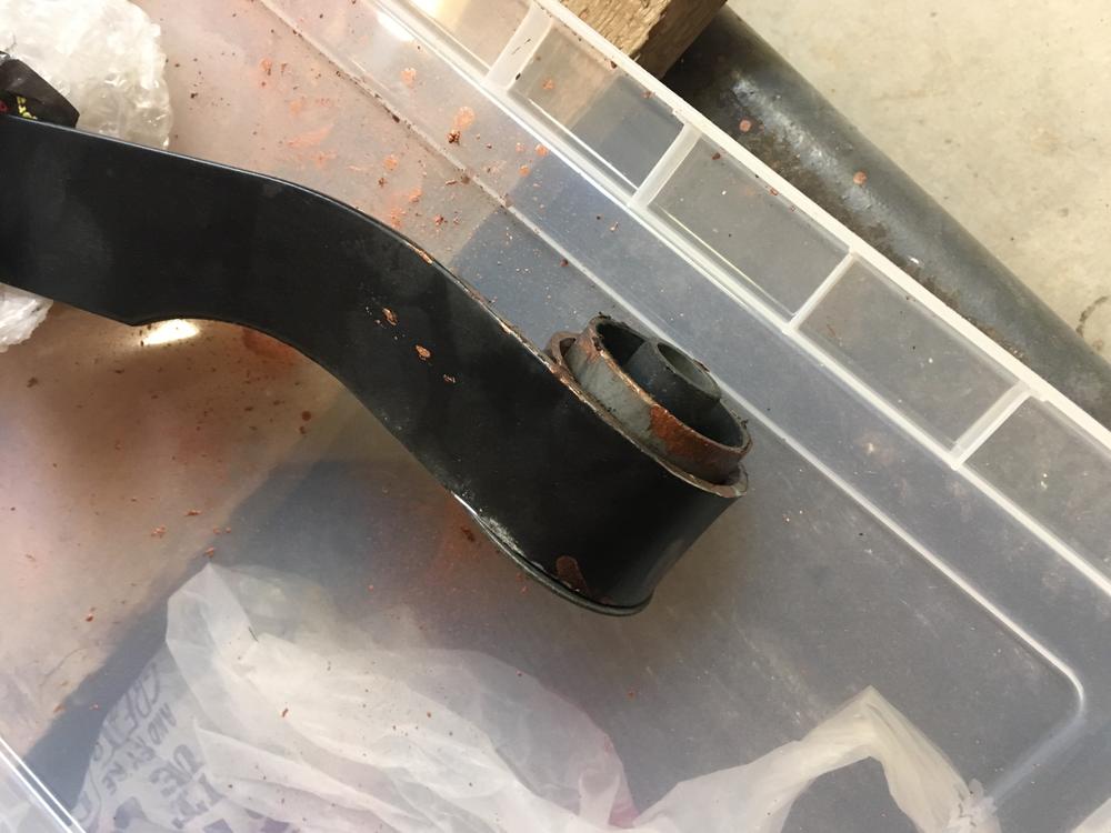

I was fortunate enough to have tracked down all the correct moustache bar parts, with a little help.

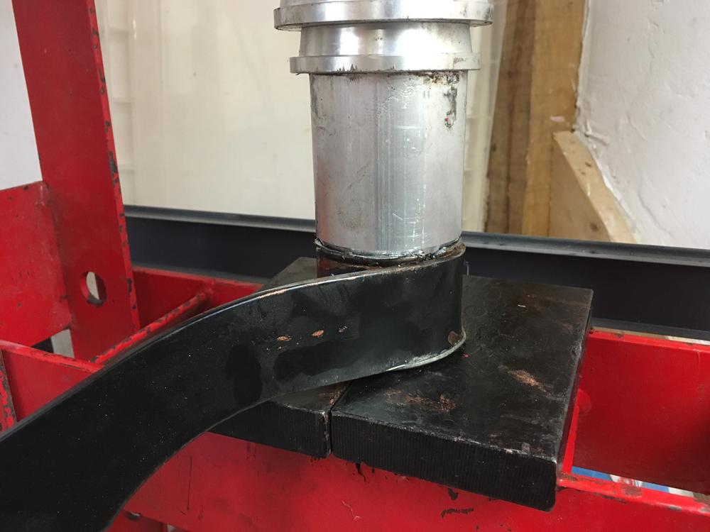

Had to make a former to make the ends correct.

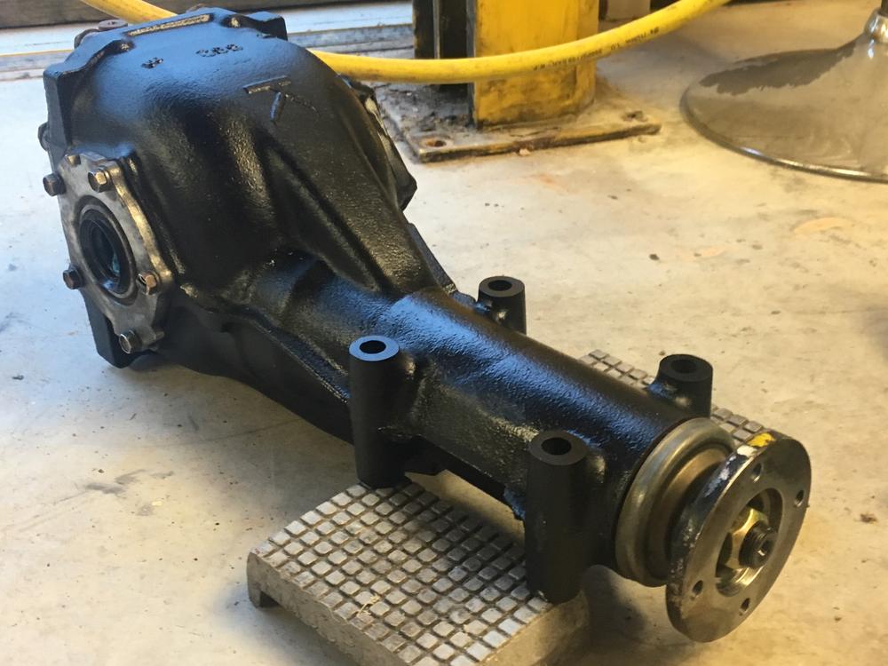

Subaru 4.44 plated r180.  Had it apart and checked bearings and wipe pattern, all perfect. I'd like to use bolts instead of the studs though for the rear mounts, can't see why not?

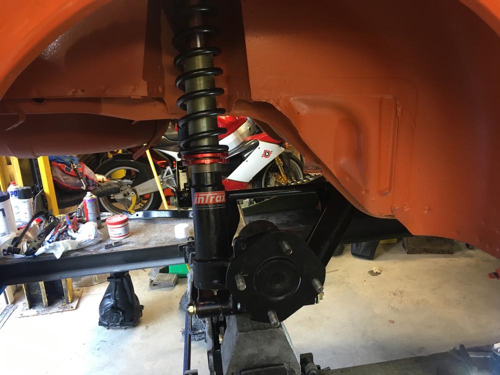

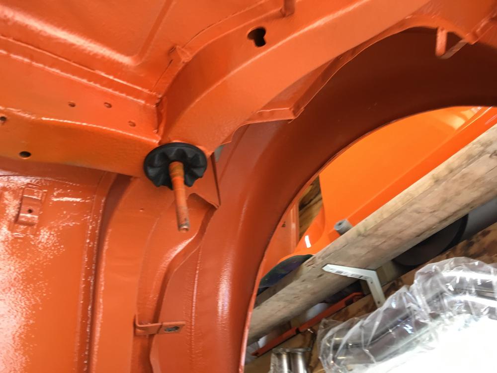

All the rear end is now in place(chassis stuff).  Rear suspension is now on.
I've just gone for new rubber bushings everywhere.

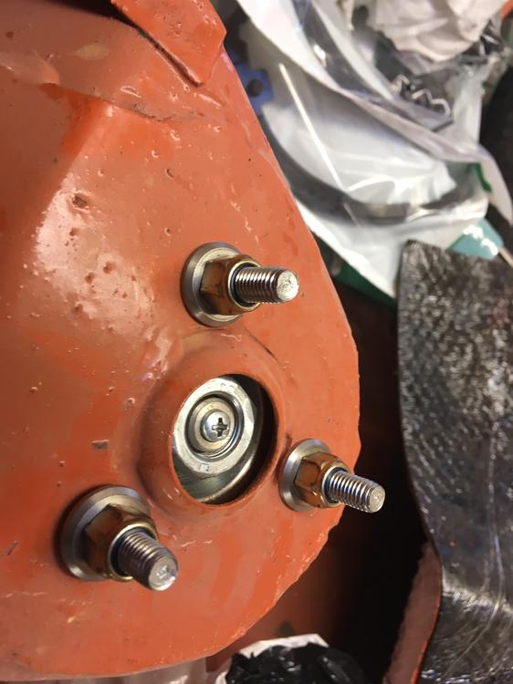

I need to check with with Ad at VA motorsport exactly how the suspension tops go together in the car, its intrax suspension with VA's road/rally topmounts.  Theres little adapters/spacers.  I can't work out if they go on the underside or inside.
Nothing is torqued down yet, i've ordered a few replacement bolts for ones i've lost.

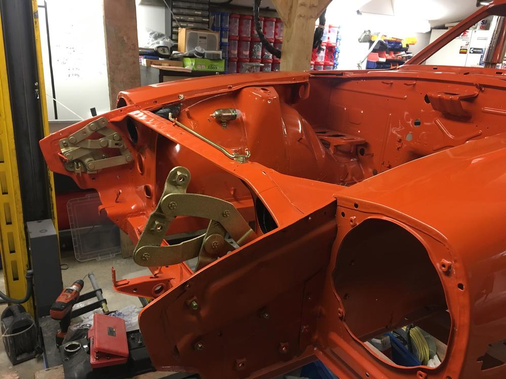

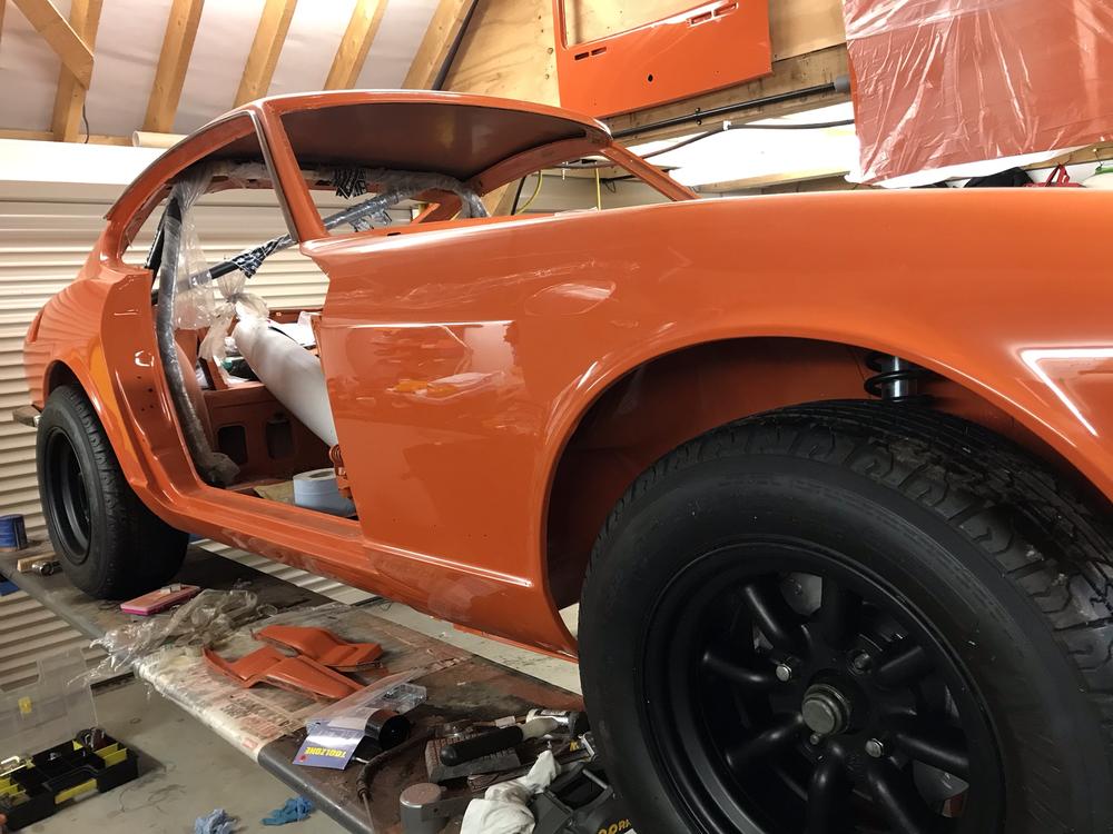

Some pretty things put back on.....

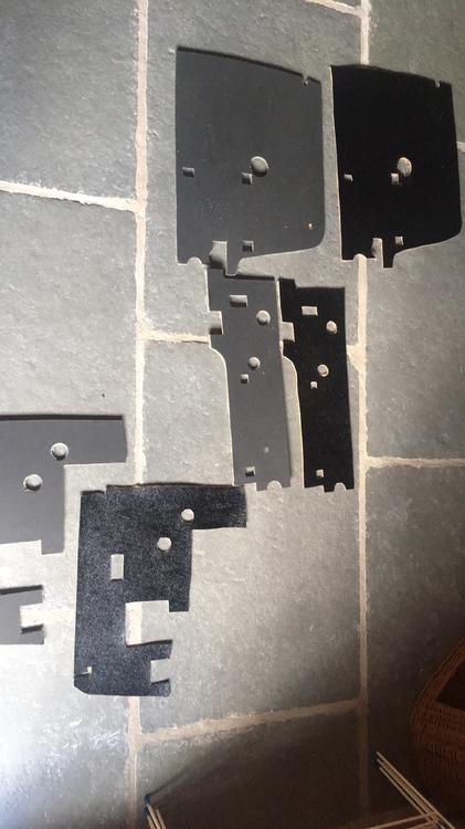

Firewall insulation cut

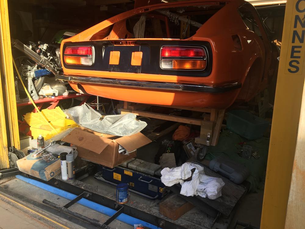

rearlights and panel

I'm impressed with the mustache bar rubbers find. They are rare items these days. Last time I heard someone finding a nos set was back in 2014.

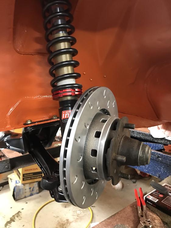

I like your caliper/disc combination.

You're through paint, which is the hard part. Maybe it will get easier from here. Did you find new crenelated mustache bar washers somewhere?
yes Alan-T had some spares, once I'd found the mustache bushings.

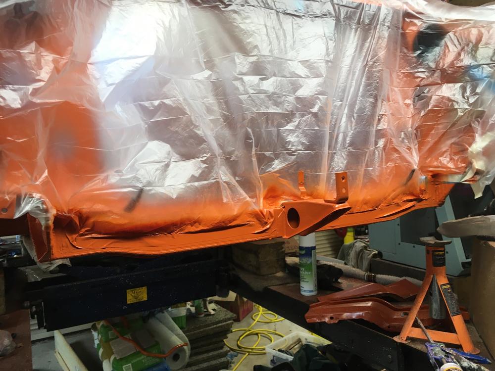

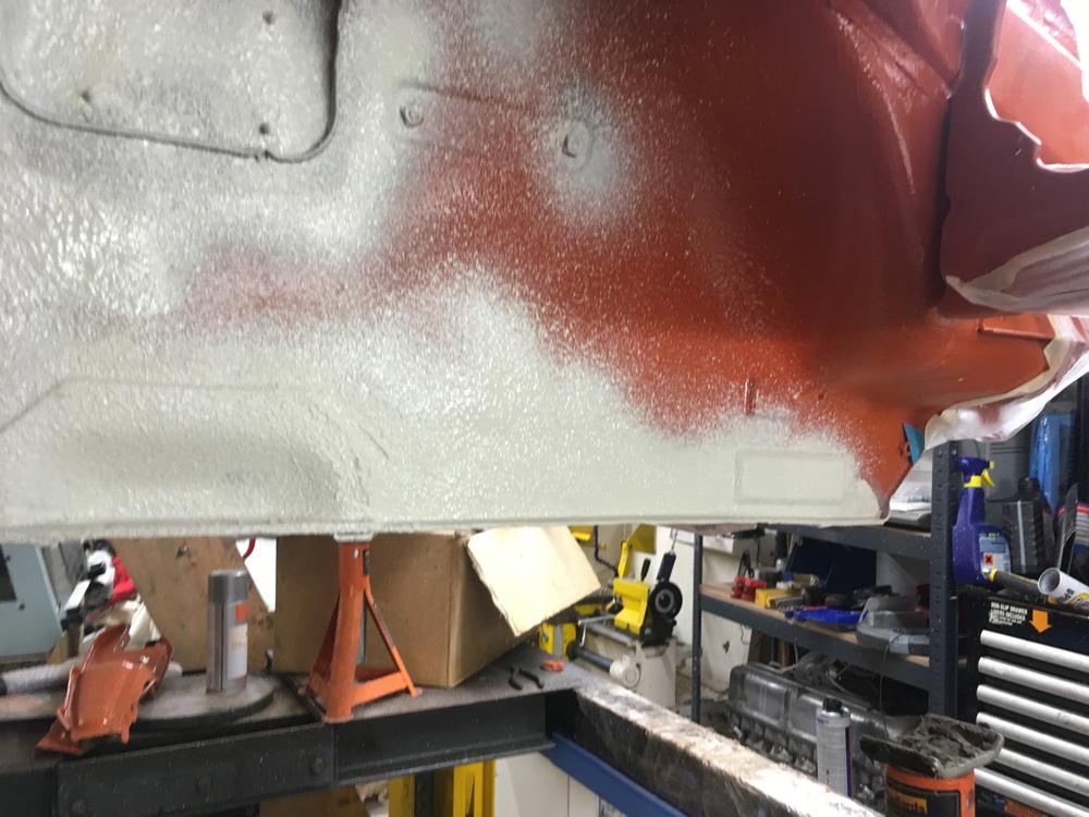

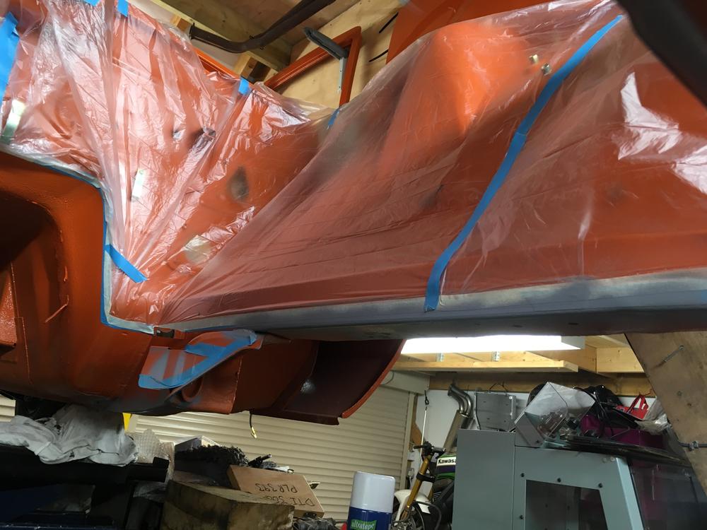

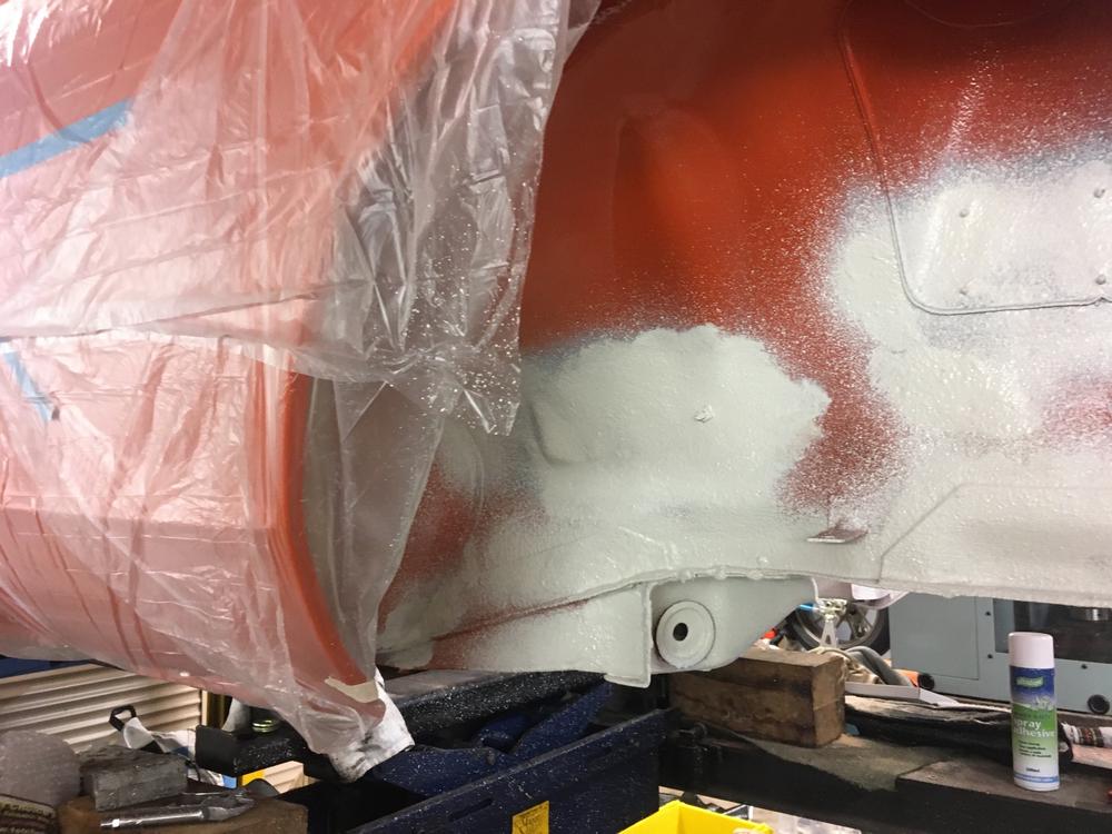

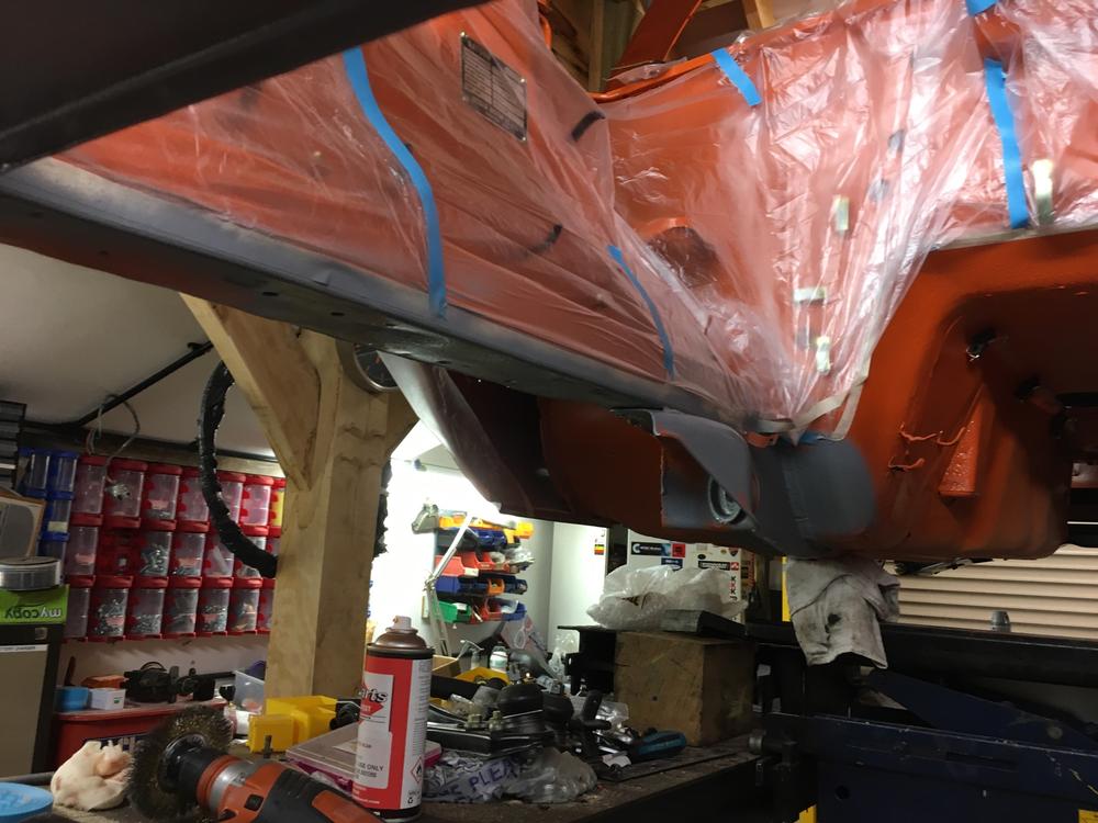

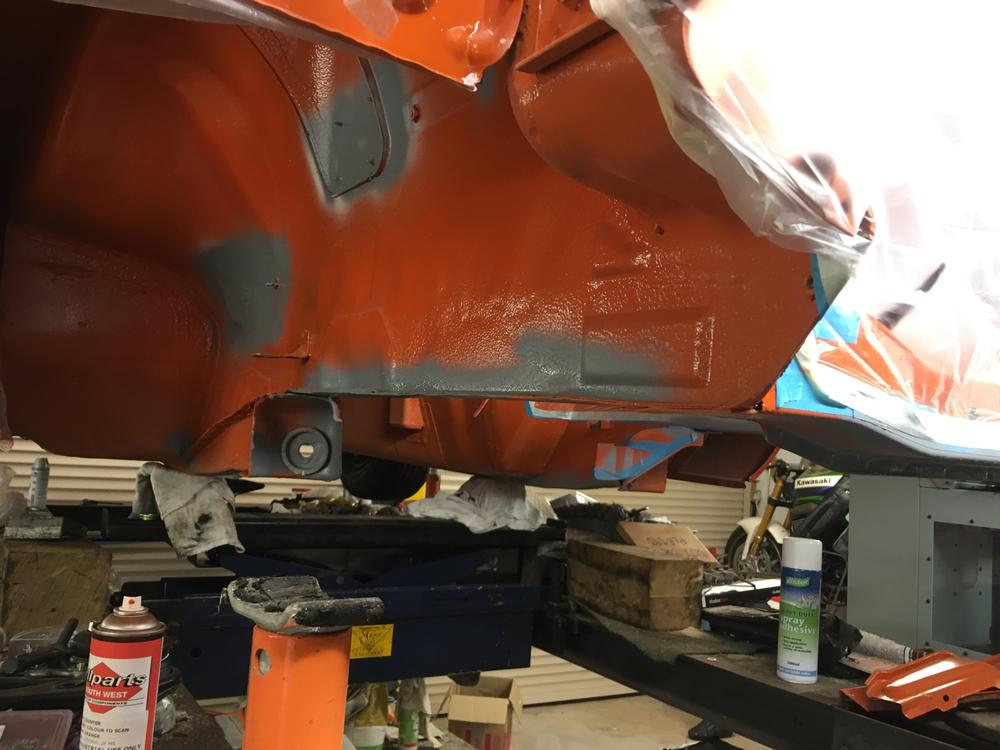

Got on with some bits i'd been putting off due to the 'fear' of doing it.
There was a tiny bit of over 'blasting' from the second round of paint that left the bottom of the rails looking like they could suffer, along with the lovely original panel joins in the wheel well, that would be prone to water ingress, so it was stripped, etched/sealed/primed/stone chipped and painted.
stone chip
all under the front also.
Then paint

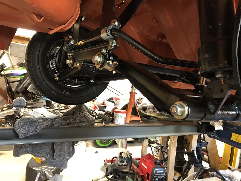

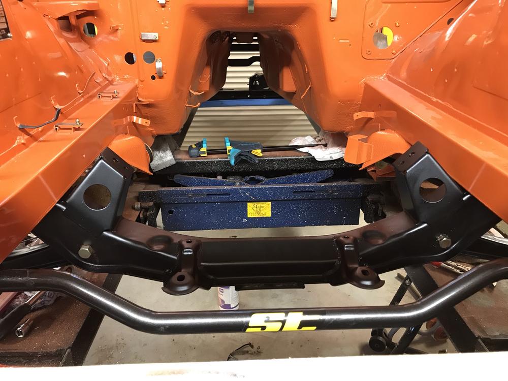

Once that was done, subframes and ARB's.

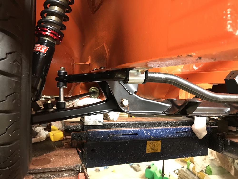

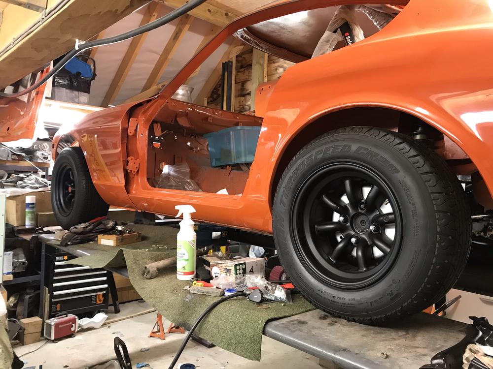

Rear wheel bearings finally sorted.  I've got a technique now, after all the practice I had! I shimmed the companion flange 1mm using 0.5mm shims, wheels turn nice and freely.

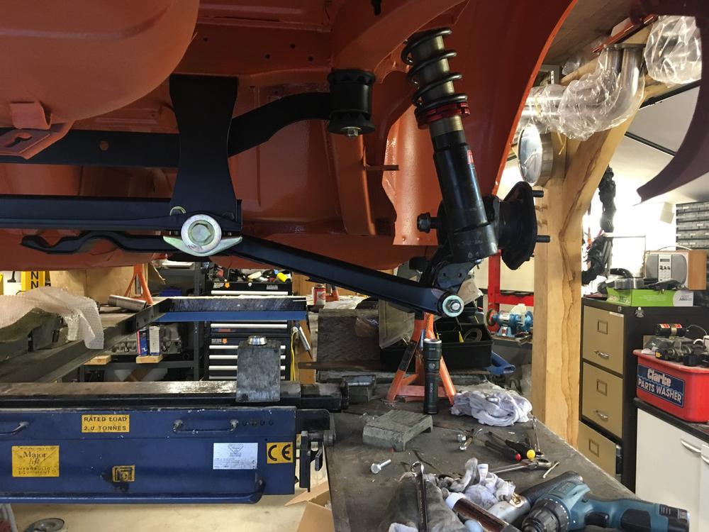

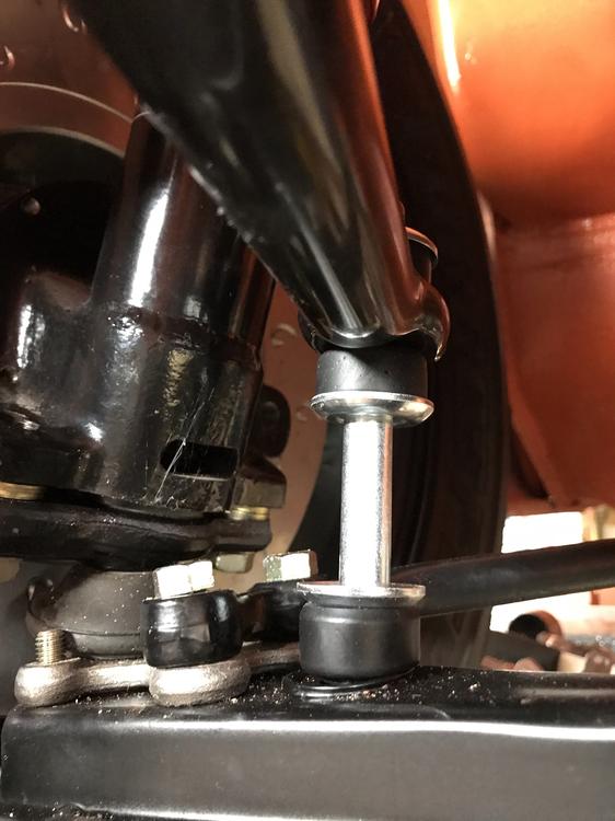

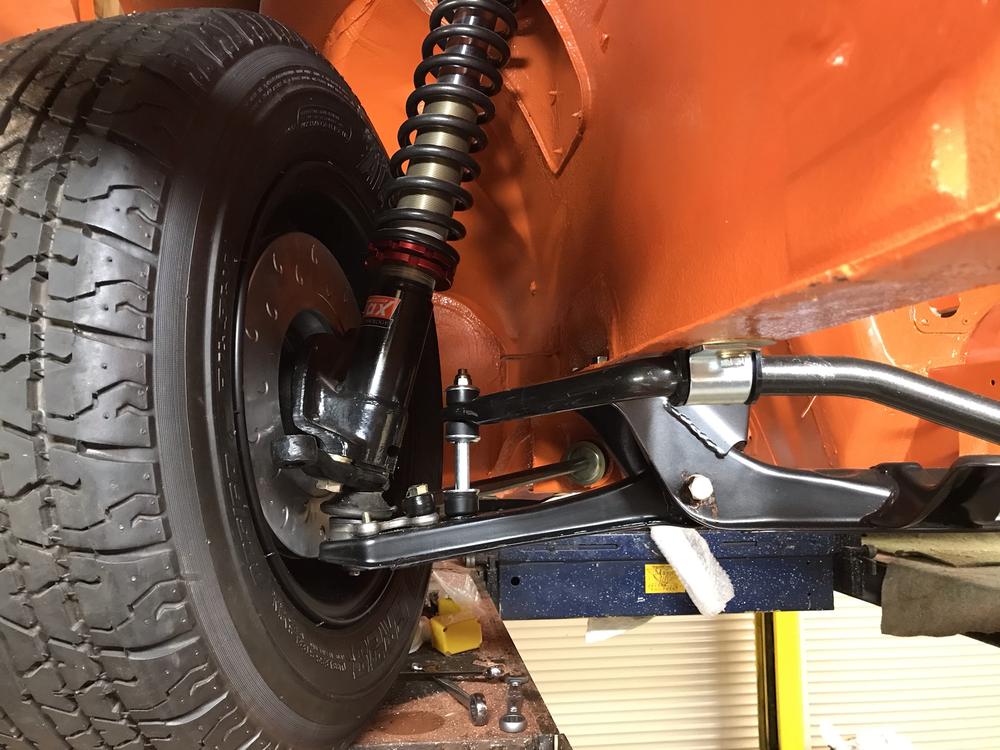

A dry build of the front suspension

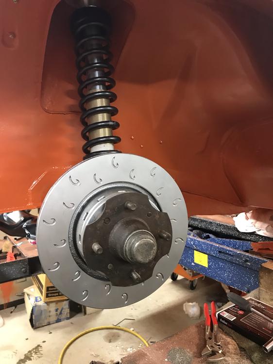

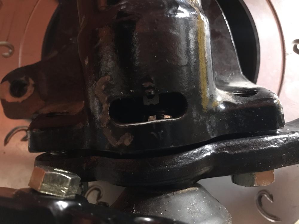

I've an issue, where the lower adjuster on the front strut hits the balljoint thread.
only needs 3mm to clear
However a set of RCA's/bump steer spacers will do the job.  Common american ones are 1" which I think is far too much, 15-18mm would do myself fine.
I've concern over how close to the frame rail the front arb is.
I can't remember how close the standard one is.  a 'fix' would be to increase the thickness of the spacer/spreader plate under the chassis rail and cutting some length out of the distance piece on the arb link.  I'll measure how much travel I get before it hits first.

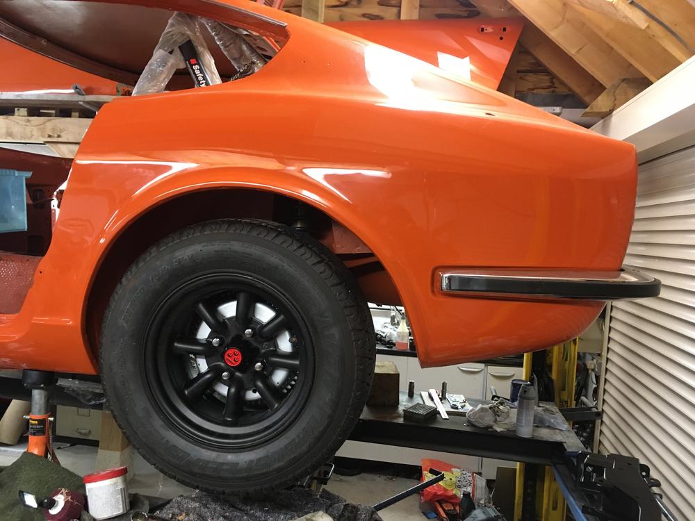

I did drop it on its wheels for the first time in 7-8 years.
