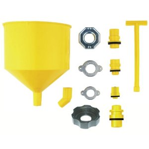

I have noticed the rising coolant when the system has not been fully bled. I would think that if you were getting cylinder pressure the car would be running poorly or you would see lots of turbulence in the radiator -all of the time. The last time I changed coolant, I used a new funnel from Lisle (Lisle funnel 24610). It will allow you to add coolant, watch the coolant bubble and bleed out the air, and get a full radiator the first time, which was Real Nice. You can get one on Amazon for $23.00
