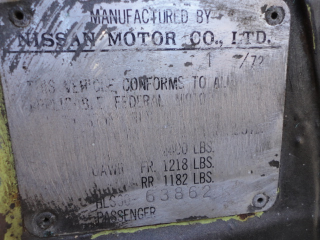

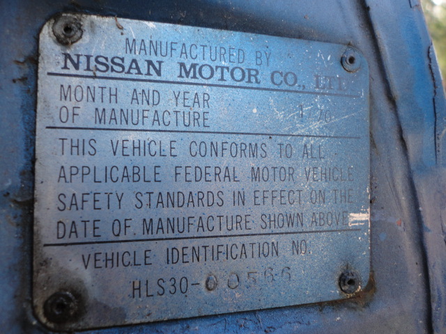

Will do, I am using some parts such as transmission cross member from my 72 240z parts car. I do have a few questions as this is my first early 70 240z. besides the early models not having any jack compartments behind the seats and the vents in the hatchback, is there any other major differences between 70 and 72? The dash in the 70 is cracked so I plan to use the one from the 72 and swap over the serial numbers, is there any changes in the dash? is wiring all the same?
