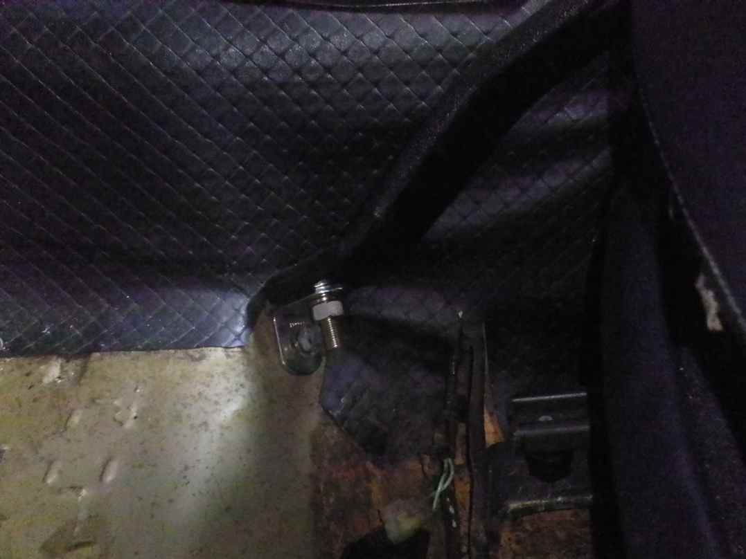

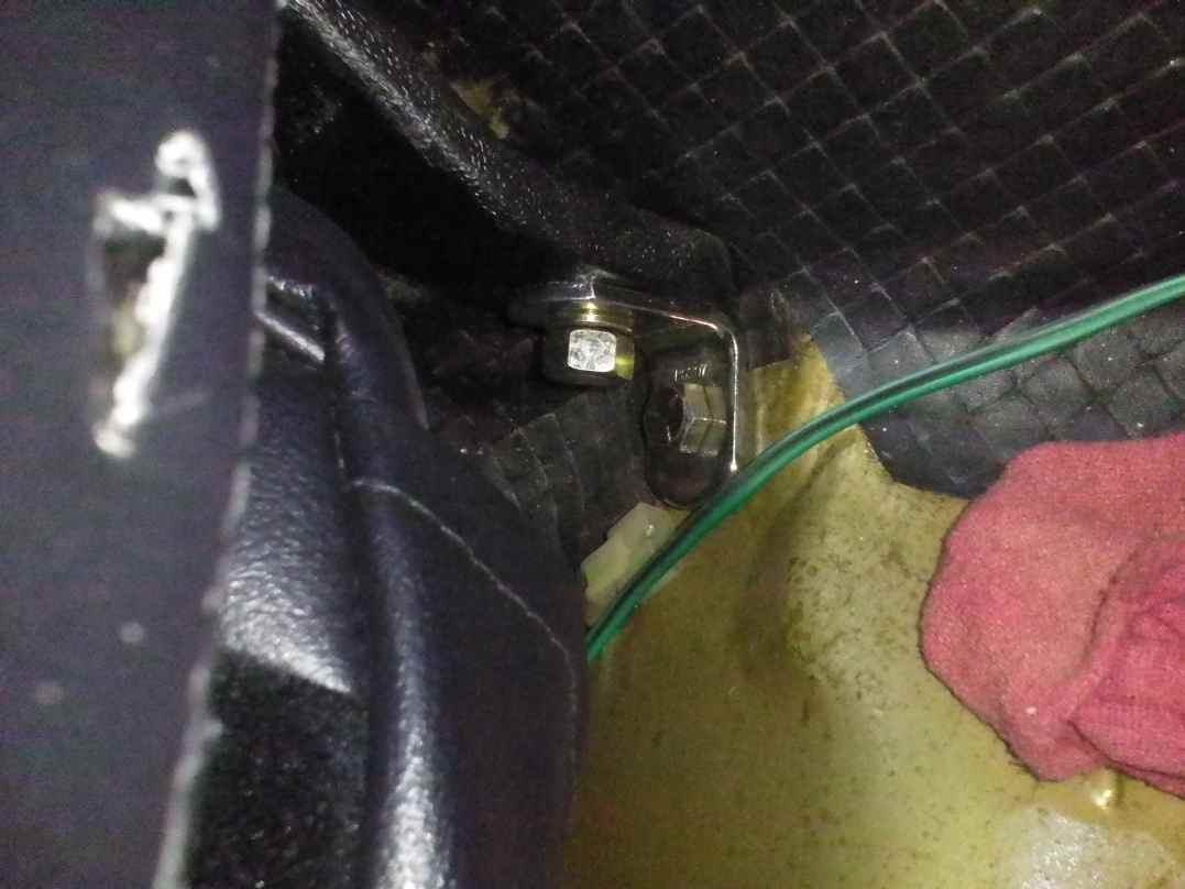

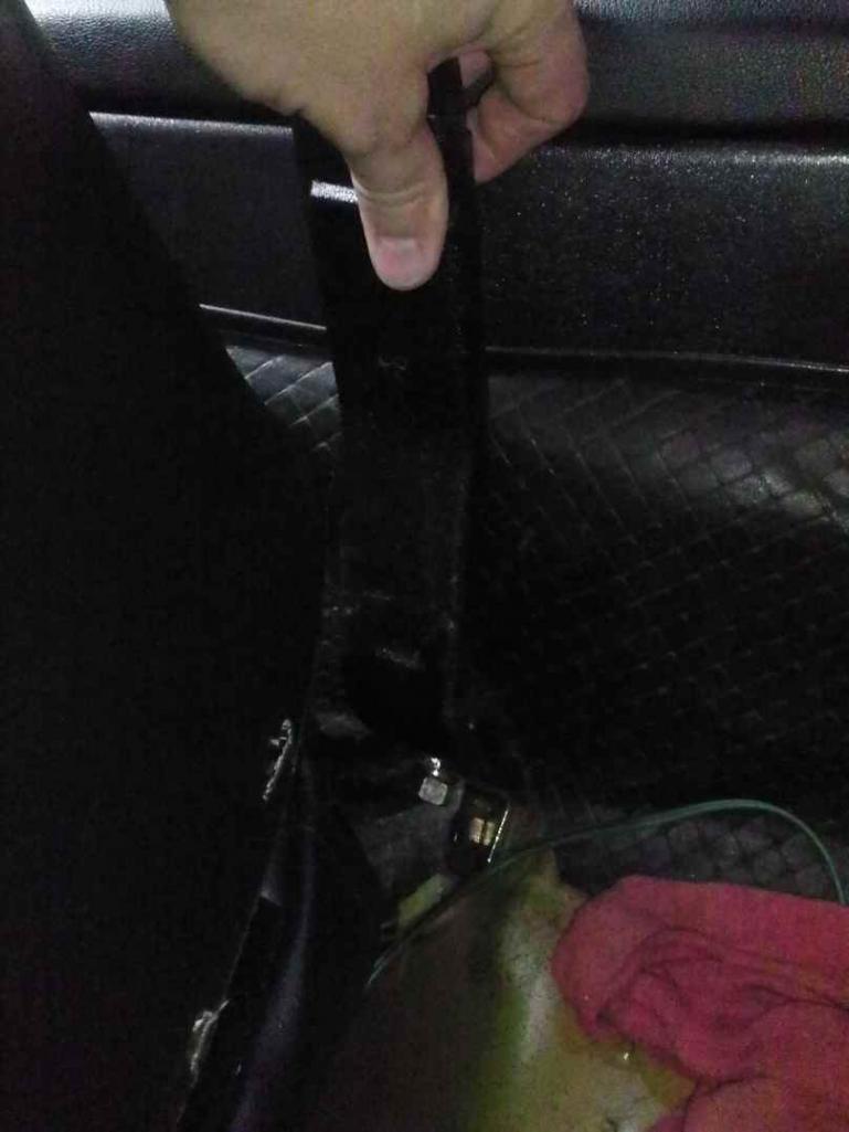

Peter,
I hope these pictures help you. IIRC I mounted the bracket loosely to the floor so that the bracket could still turn. Then I ran the bolt through the receiver end and through the bracket. I tightened up the bolt through the receiver, swiveled the bracket back into place, and finished tightening the bracket to the floor.
Steve
Steve,
Thanks so much for those photos. I realize that my problem is that I have two layers of Dynamat on my transmission tunnel, which interferes with mounting the receiver the way that you did. I guess that I can either remove some of the insulation or cut the the scabbard and mount the receiver without the L bracket. That would be easier.
My other question concerns the mount on the sill. If I install the mount with the flat part against the sill, the belt is twisted. What did you do?
Peter
Thanks Steve. Following your photos made the job easy and I finally got the interior finished today. The belts work very smoothly and look almost stock. I may raise the driver's seat a bit to re-position the shoulder belt, but otherwise this is a great addition and I recommend it.
