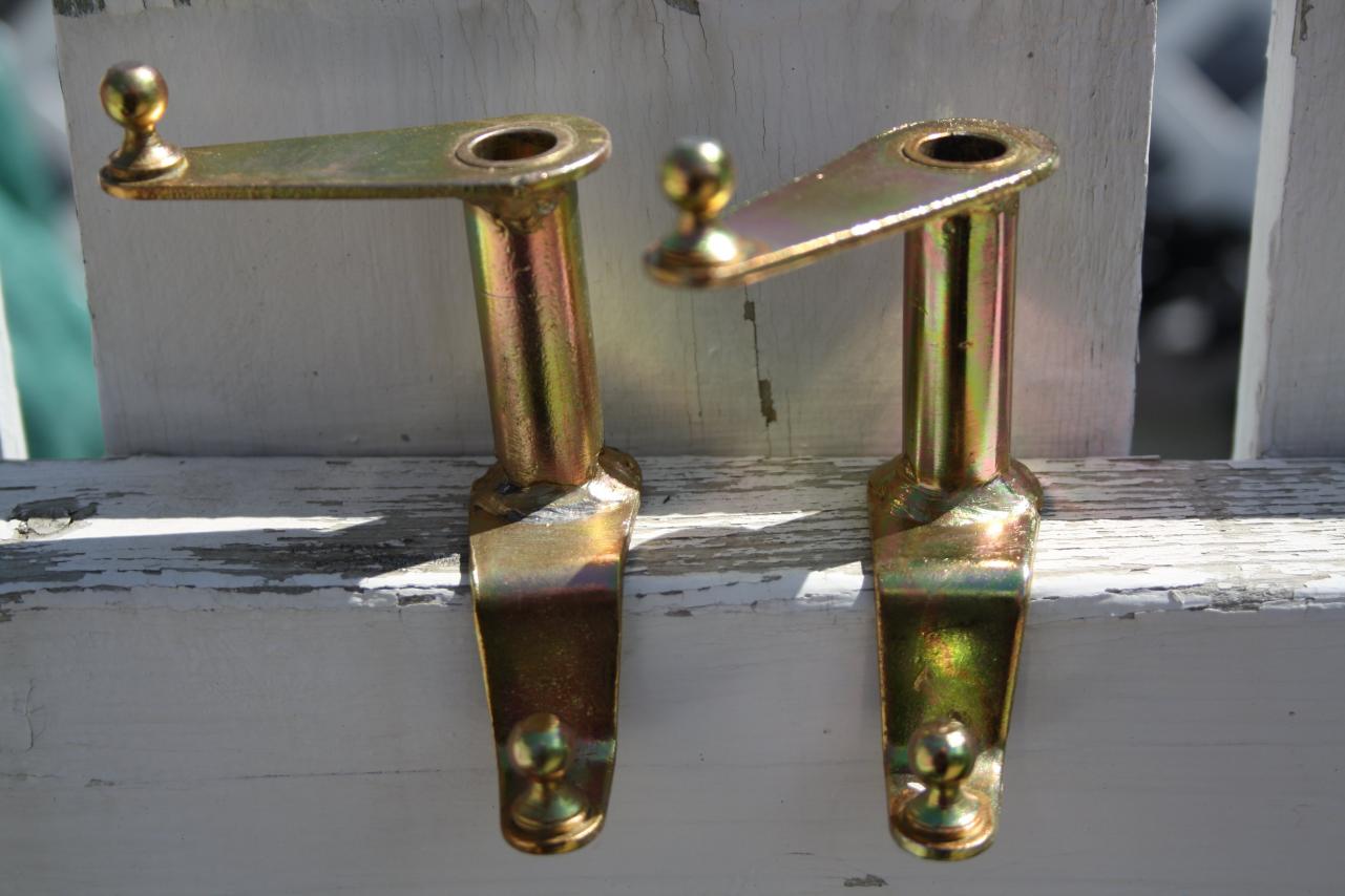

I seem to remember there was a linkage made that went some way to fixing the jerky feel of the 240 throttle .
I think it altered the ratio somehow.
Does anyone know of this.
This might be it, http://www.zhome.com/ZCMnL/tech/AccelLinkage.htm
Here is a photo of what I tried. I cut the main tube in half and the welded it back together at the new angle.
