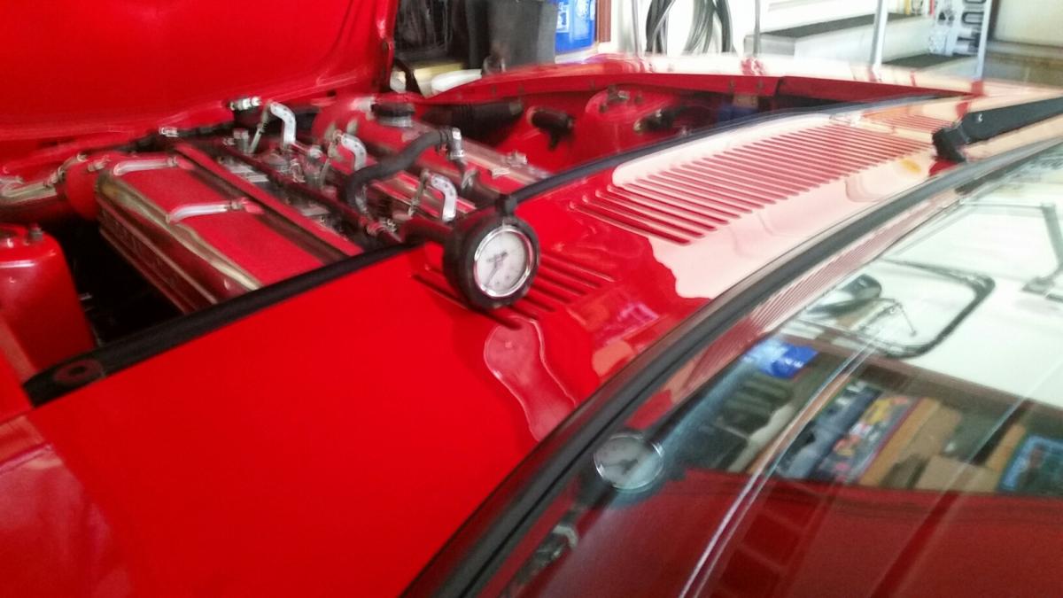

I ran a fuel pressure test right at each carb with no return line and got 3.5 psi.
I then did the same test with the return line hooked up and got 3.25 psi.
I decided then to leave my return line hooked up. Continuous cool fuel supply that way.
This is without  a fuel pressure regulator of course.

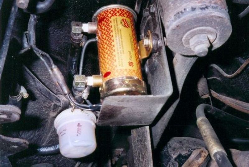

Well it wasn't terrible, but the pressure wasn't stable. At WOT pressure dropped to 2psi. Pressure was also shaky in transitional areas. Upon looking at the numbers on my fuel pump I realized that I had installed (and recommended-sorry) a pump that probably is slightly to small in volume. The rx7 pump was made for a 1.2 liter rotary and requires only 15 gph(2-4psi)
Maybe sufficient for a stock Z with SU'S , but not enough for my engine.
I have ordered a Carter p60504 to replace my pump. It's rated 4psi at 30 gph.
Reading Racetep ' s page they run Carters with 4psi and no regulator on all there set ups.
Waiting on the pump and leaving the pressure gauge in place to see the changes.
I will say that after adjusting my Holley regulator up right to 4 psi the car ran really well- EXCEPT it stumbles in transition sometimes and I can watch the wideband go lean. I'm thinking -hoping - the increased flow with help keep float levels at optimum level to combat my lean issue.
We will see
