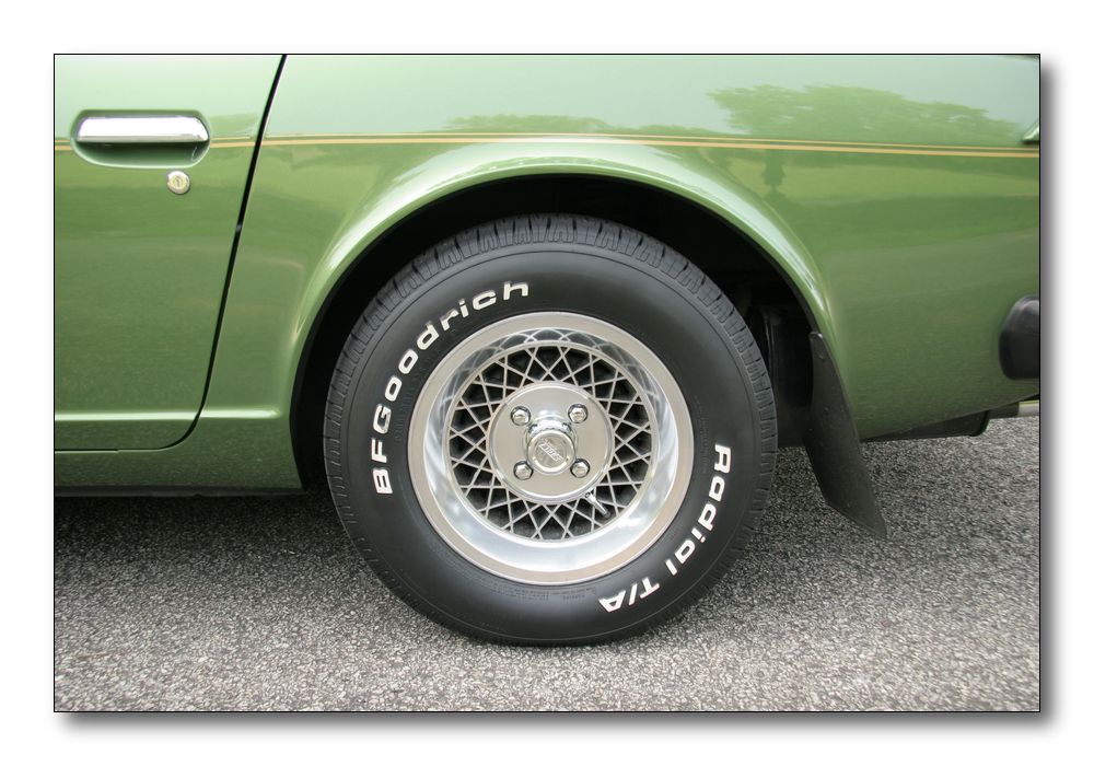

April 29, 201212 yr comment_388669 I have a set of Appliance "mesh" mag wheels that I had remachined and needed new lug nuts to replace the old rusty ones that I had. Bought them on eBay, I believe from Massey's. The washer that they use is separate wheras on the originals they were integral to the lug nut itself, but the new ones worked great never the less. Good transaction without any issues.You can see his most recent auction for the same ones that I purchased here:http://www.ebay.com/itm/20-LUG-NUTS-FOR-APPLIANCE-WHEELS-NISSAN-DATSUN-12MM1-25-/350316425227?pt=Motors_Car_Truck_Parts_Accessories&hash=item51907c700b&vxp=mtrMike. Link to comment https://www.classiczcars.com/forums/topic/43074-appliance-slot-mags-lugnut-bushing-type-adapters/#findComment-388669 Share on other sites More sharing options...
