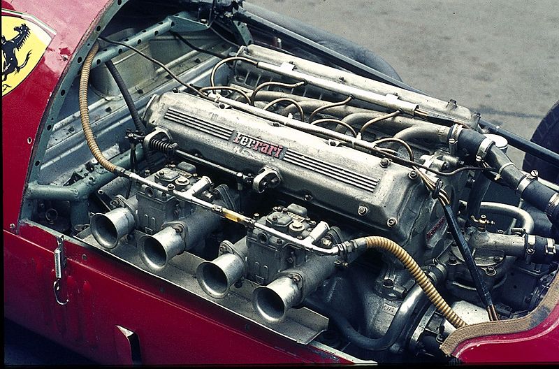

Here's an interesting tidbit... I just found out my Triple Webers are rare as hell! I have 42DCOE 8 triples. They apparently were commissioned by Maserati in the 1960's and were also used on Morgans and Triumph's...
The reason I was researching them is I was thinking of selling them and going with 40DCOE 151's for the idle adjust-ability.
molto bello
