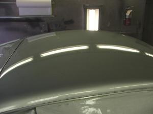

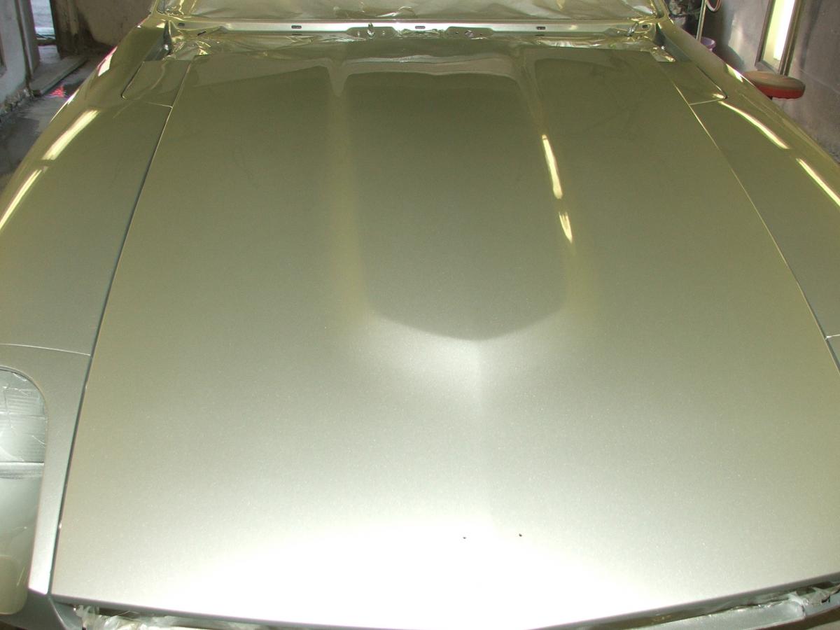

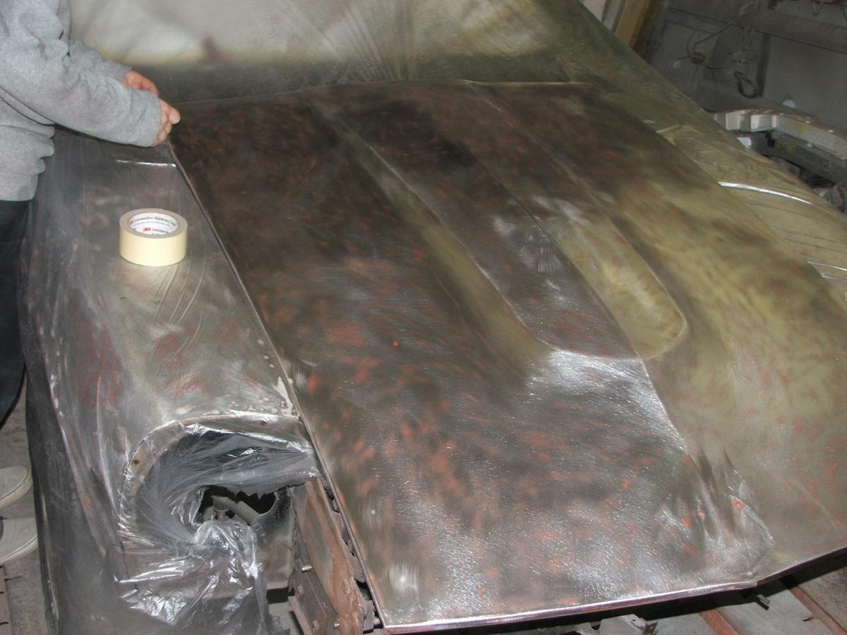

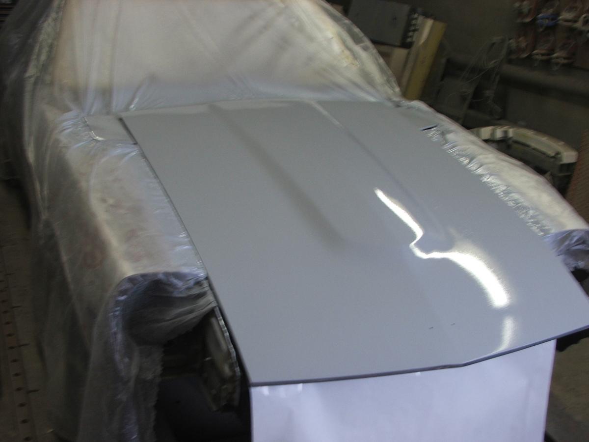

My brother has his own body shop and has been at the trade for about 30 to 35 years.
I watched him straiten and smooth both the hood and roof on my Z prepping for paint.
The roof was dented due to being sat on some where in a previous existence and the hood he just got fussy.
He used the heat  and just worked the metal that way.Using expansion and contraction and a little impact here and there.
That is something you will not see today but he spent about 10 hrs just working on the metal before he skimmed it and started blocking everything.
With him it is pride in his craft plus he didn't want his big brother to pout LOL
The roof is really good but the hood is amazing how absolutely straight it turned out.
