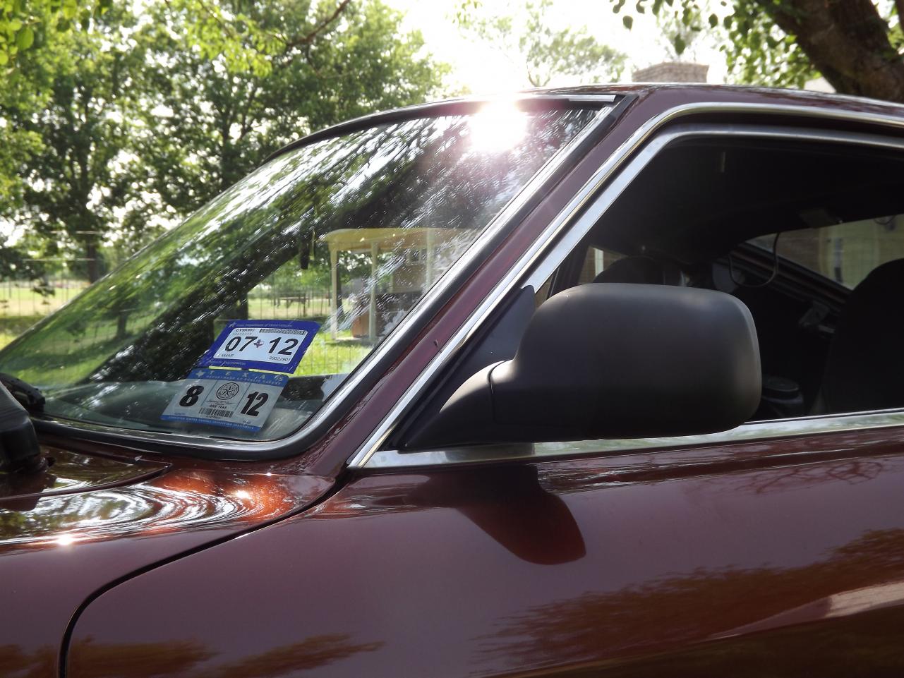

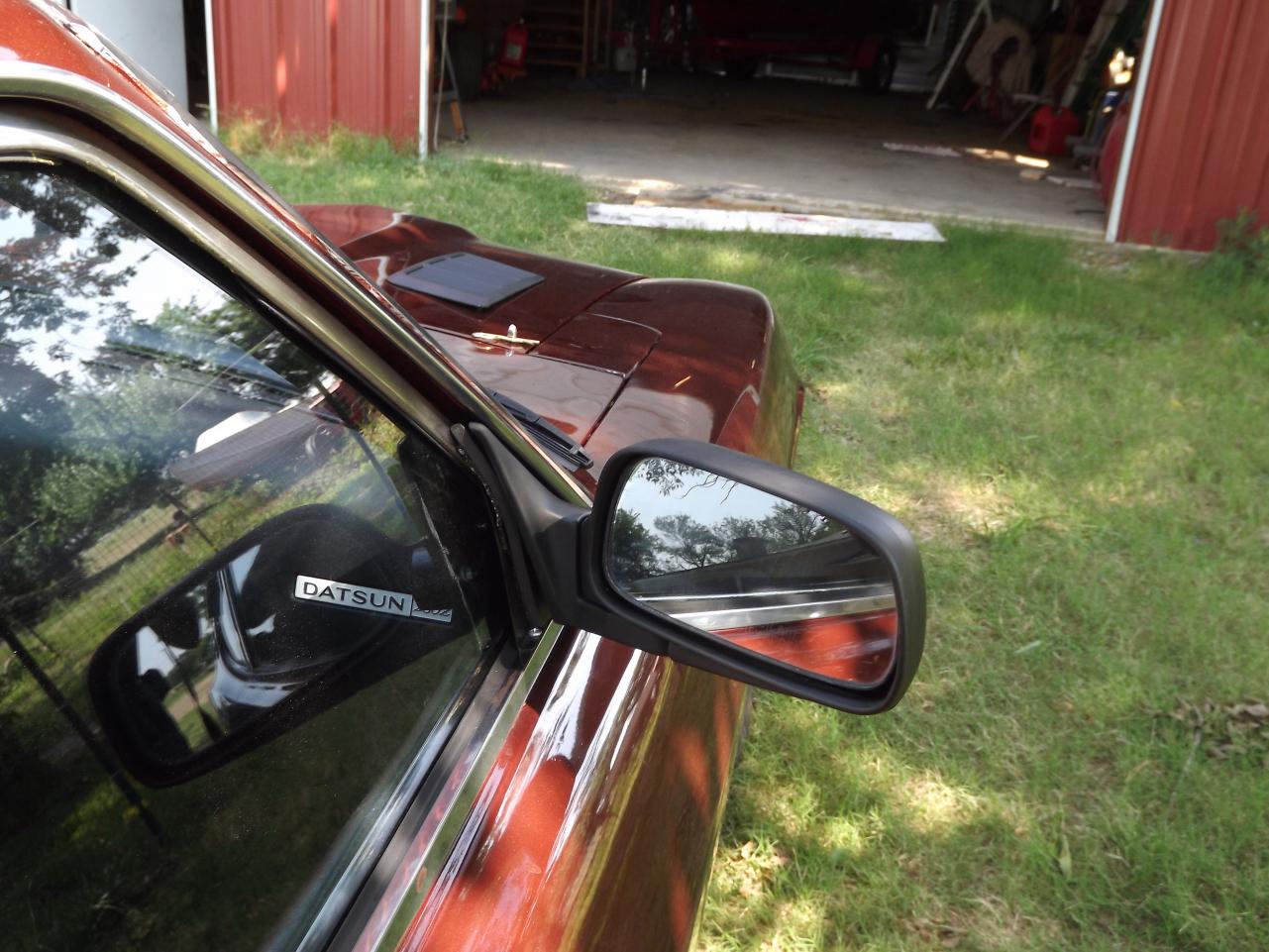

These are from a 1995 Lexus 300 sedan. I cut a gasket out of some 1/4 inch rubber I had laying around and bolted them to the MSA brackets. These babies weigh about 3 pounds apiece and dang sho do not shake! I don't have the electric hooked up yet but I robbed the dash switch and do have a wiring diagram. post-24605-14150819110824_thumb.jpg
Edited by johnbell47
I said these are from a GS Lexus, I think I am wrong, I now believe it to be an ES
