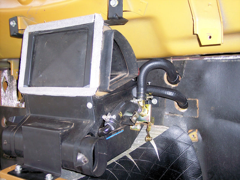

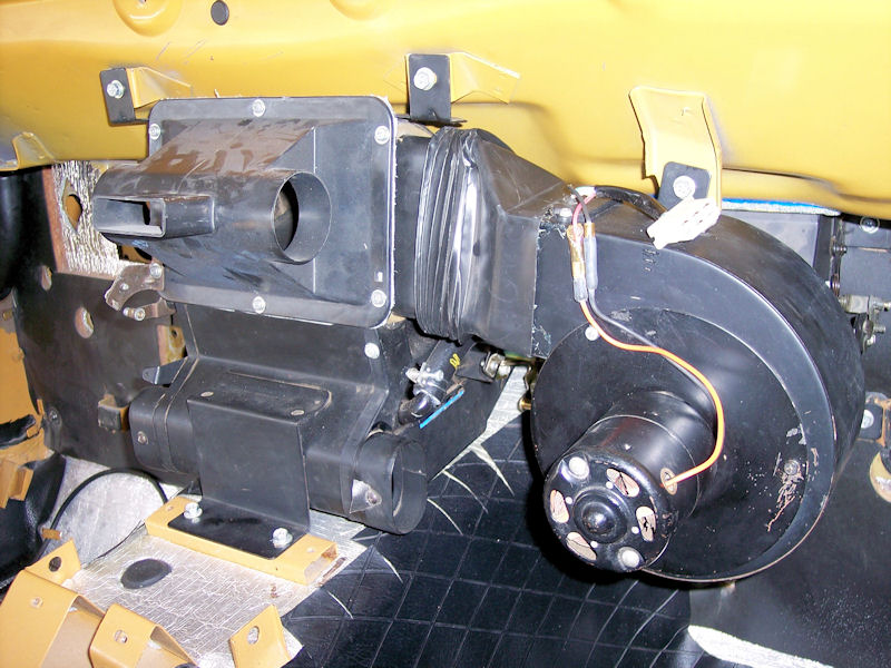

May 16, 201212 yr comment_390238 FYI... this is what eveything looks like under the dash. I find it always helps me to have a picture in my head of what I am dealing with. You can see the short curved hose mentioned above. If I recall correctly, MSA sells the genuine Nissan part (pre-bent). Hope this helps. Jim Link to comment https://www.classiczcars.com/forums/topic/43209-replacing-heater-hoses/#findComment-390238 Share on other sites More sharing options...
