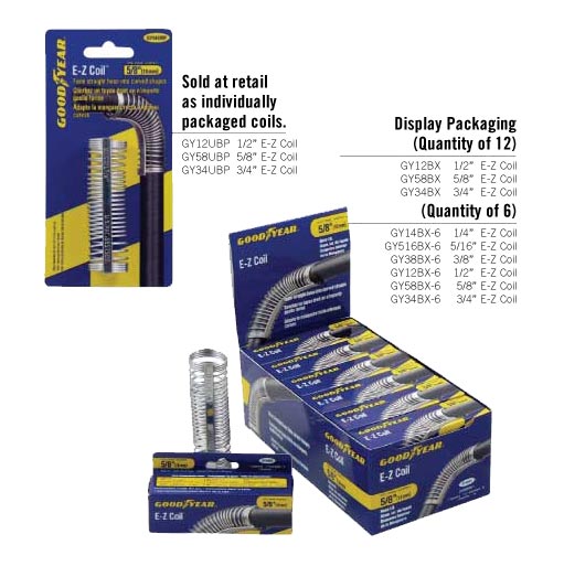

or splice on a piece of a heater hose from some other car with a 180 bend, or use a goodyear external metal coil we've spoken of here (e-z coil?) meant to support a home made bend. Or since that line only carries fuel vapours, don't sweat the probability of a 1/2" copper fitting made 180deg bend failing anytime soon from sulphur embrittlment...
