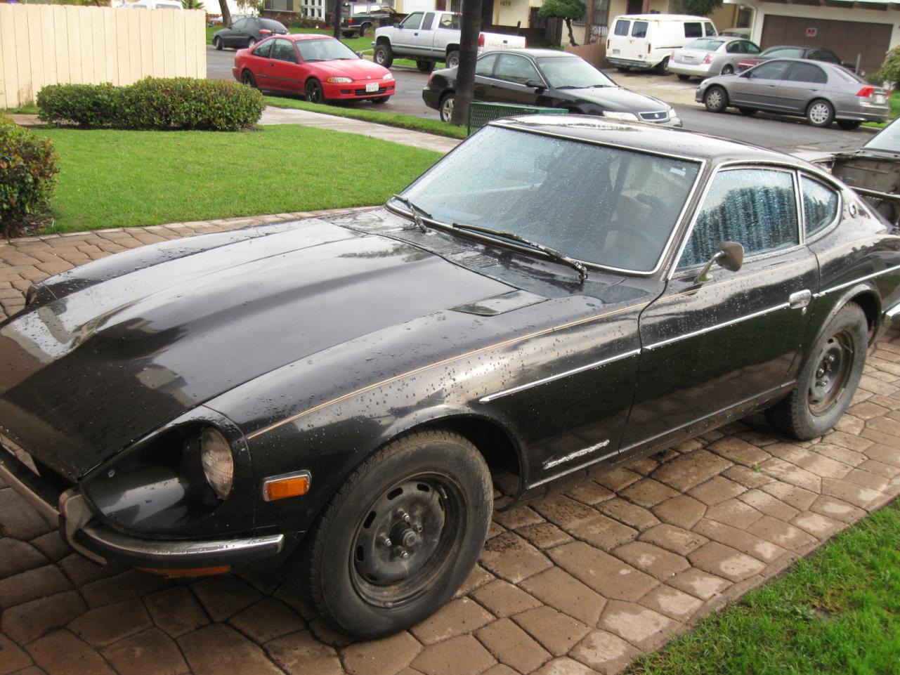

Thought I would start a thread in lieu of finally getting my 71 running this weekend!!!!
The car had been in a 5 year hiatus before I bought it, and due to other projects has sat for another 2 years while in my possession.
But on this memorial day weekend I was determined to get as much done as possible with the single goal of getting it going.

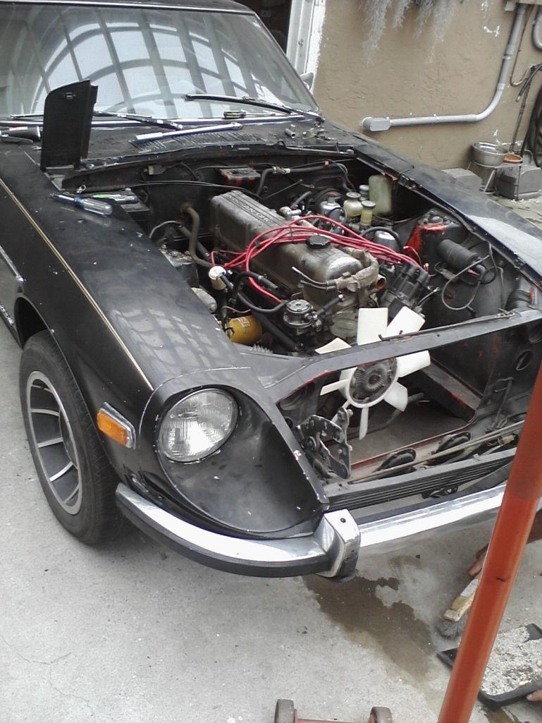

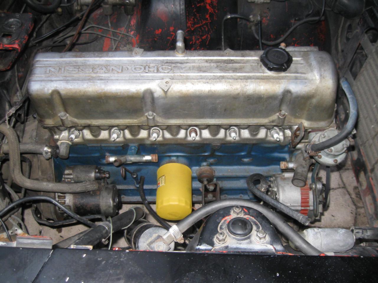

The car came with a l28 head l24 combo:sick:, which also happened to be missing a valve guide. The engine was swapped out for an l24 block early e88 head courtesy of CL.
I installed the engine a while back, had the SU's rebuilt, and toyed with ideas of elec ignition.
Yesterday, with everything hooked up, stock points distributor installed it started right up and rev'd great! Never mind the clould of smoke!
Today we installed the E12-80 distributor and did some further syncing of the the carbs. Idles really well,
Really happy with the progress! As any running Z gets the nod in my book :D:D

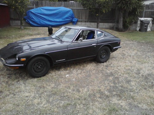

Theres the shot taken from the phone. So happy with the progress!

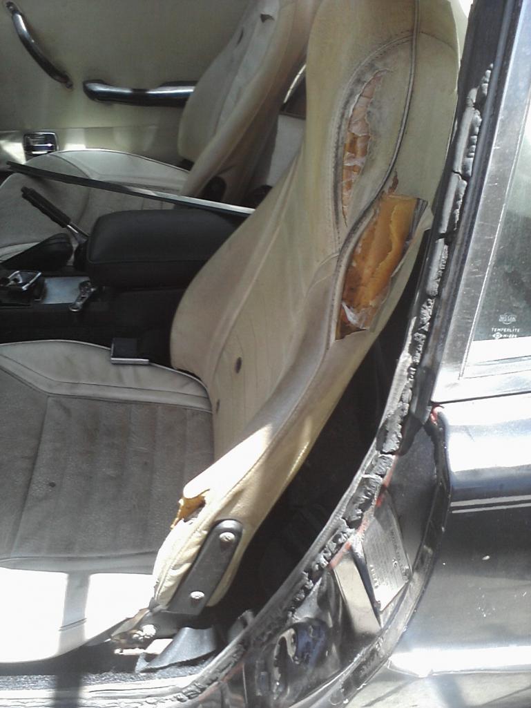

- I pulled the drivers door apart to get the regulator out as the window was pretty much dysfunctional. I cleaned all the old crud off the runners and regulators and reinstalled. It winds great now, but needs more adjusting to line everything up.
- Also got started with the weatherstripping. I pulled of the old stuff (which made a complete mess) and installed the new, and trimed about an inch off. Door closes fine and the fit was great. More testing to come. Theres a pic of the old stuff.post-22306-14150819335212_thumb.jpg
