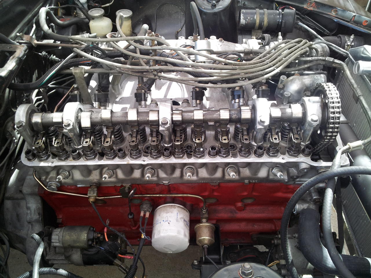

Thanks Chas, yes tons of work and time in to it. Working on a video. Will be putting in a n/a 5spd next week with any luck .
[ATTACH=CONFIG]67564[/ATTACH]
So why are you taking out the T-5? Admittley the Nissan has better ratios but you will hate the shifter after you have been using the Mustang shifter.
Your project looks good and you are running MS2?
