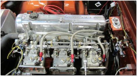

I took the liberty to refine the fit on the studs of the CANNON manifold the webers fit on. You see, the kit they provide for you comes with nice new studs, but they do not tell you to NOT screw them in all the way. IF you do that, when you go to mount the lower locking nuts OVER the springs you do not have enough thread sticking out to start the nut! It can be a cause for much foul language. So I started to back all the studs on the bottom out about 1/8". Easy enough. Then I come to a perplexing discovery. Upon trying to reattach the throttle bar where all the throttle arms attach to and actuate all the webers, I notice the CANNON manifold is not properly aligned. Let me explain. The CANNON manifold has three holes drilled and tapped where three rod ends screw into it. These rod ends hold the throttle linkage bar. When I screw in my rod ends into my manifold, I notice that one is distinctly not lined up with the others. This is cause for my slow throttle return at times. I noticed my pedal always had more effort than it should have, and at times the weaker return spring did not quite get it back to idle as it should when you let off the gas pedal. This misalignment was causing some mild binding. I need to find a way to fix this. More pics to come.
Sure have Frank, but just backing these out 3-4 turns still leaves 80% full thread depth engaged into the manifold. I think that will be fine considering the extremely low torque these see. I will still locktite them in for good measure though
I have a solution for your mis-aligned cannon mounting holes. Remove the rod ends. Mount a 1/2" thick by 3/4" wide aluminum bar to the the manifold using those holes with bolts. Drill and tap new holes in the bar to mount the rod ends. Plan the layout of the rods, linkage etc carefully.
Aside from solving the mis-alignment issue, it makes it possible to remove the linkage bar without having to pull the manifold, since normally the rod can only be inserted with the manifold above the engine bay. I've done this on my car and the latest one I'm working on, pictures attached. Makes servicing and playing different actuation games simple. (note my snazzy cable throttle).
You can always weld up the one mis-aligned manifold hole and re-drill and tap it in the right place too.

I had the same problem with my Cannon manifold in terms of the rod end alignment. I totally agree with you that this contributed to the slow response time of the Weber throttle system especially when returning to idle. I solved the problem a different way than the way that zKars described above (which seems like a very elegant solution).
I simply removed the middle rod end and replaced the throttle rod with a very hard stainless rod that I purchased from McMaster. This way I still had the desired stiffness of the rod (so there is no flexing when you exercise the throttles) but had perfect alignment as there are now only 2 attach points on the manifold. I have run my car this way for more than 6 months with no issues what so ever and the throttle response (especially return to idle) is better than it has ever been.
This also has the benefit of freeing up some space in the middle of the intake which has made the installation of my throttle cable easier as there was much more room to deal with.
