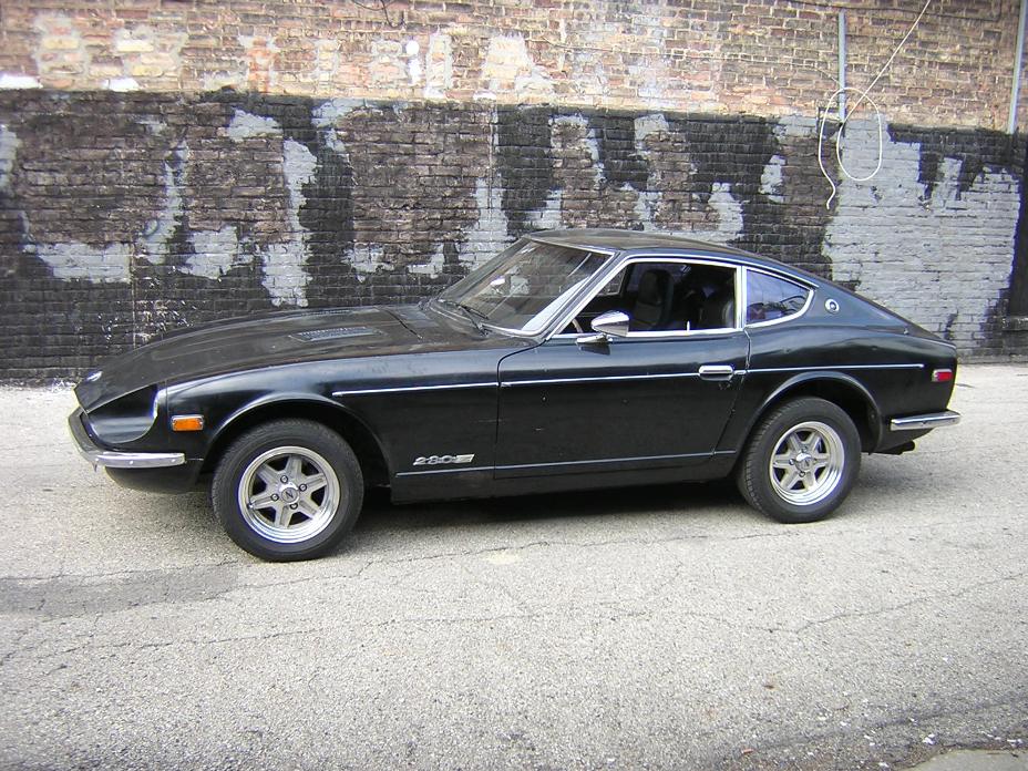

I kind of like the front without the bumper guards, though I wish I had some for the rear. I just finished the initial test fit of the '72 bumpers on my '78 and I really like the look, though the car sits a bit higher now after pulling the bumper shocks out (to be cleared up once the strut inserts go in and another inch of rim is added, I'm sure).
I couldn't use the fronts anyway because they block the turn signal lenses, but here's a shot for the heck of it:
Since my car is a bit of a rat, I decided to forgo the $200 worth of rubber strips and just throw $10 worth of carriage bolts in the holes instead. When she eventually gets a repaint, the rear pan will be gone over and the bumpers rechromed, etc. Anyway, sorry for hijacking the thread! Keep up the excellent posts, can't wait to hear your Z run!!
