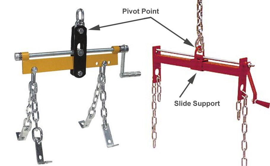

If you are going to buy an Engine Leveler - spend a little extra money and get a fairly good one. This one from Jags or O'Reilly for example are a better design than the less expensive ones. The cheap one's can be a complete PIA as they jam or slip in jerks and starts.

Picture Below:
Cheap one on the Left {Yellow} has a Pivot Point higher above the slide bar, so finer adjustments are harder to make. The cheap one on the left uses a round bolt to support the slide bar and above the bar so there is too much play and they do not operate smoothly..you crank the handle and nothing happens so you crank some more - and then the slide bar finally jumps to the next position... Hard to describe but anyone that has used one knows what I'm talking about.
The more expensive one on the Right {Red} has pivot point closer to the slide bar and more stable slide bar support. It also has a finer thread on the rod which give you much smoother action.

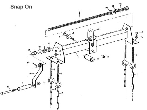

Snap On uses a roller bearing for the lower support of the bar...{expensive!}. But note the design of the Snap On and the red one from Jags..
The one from Jags is $60.00 vs $25.00 for one from Home Depot.. The extra $35.00 is worth every penny.

......there is too much play and they do not operate smoothly..you crank the handle and nothing happens so you crank some more - and then the slide bar finally jumps to the next position... Hard to describe but anyone that has used one knows what I'm talking about.

You could not have stated it any better... when they do that small slip,it is startling and can hurt flesh or metal if one does not pay attention.
