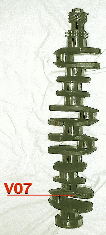

The Maxima diesel crankshaft is the one you want to build a stroker. Pick up the book written by Frank Honsowetz entitled "how to modify your Nissan & Datsun OHC engine." In chapter two, "crankshafts," on page twenty, he recommends the LD28 crankshaft for a stroker an L24, L26, or an L28.
If you need one, I have one for you. They usually run about $225 - $300 on zcar.com for sale forum. I'll sell mine for $175 cause your a Classic Z Car Club member.---Jerry

I don't suppose you, or anyone else, can give me an estimate on how much this crank weighs? It's a possible future project and I'd have to ship one over from the US (Gulp!).

Grab an F54 block with an N42, or P90-shaved and have it bored 3mm. Find an LD28 crankshaft (or buy mine), a set of 73 240Z - 9mm rods, a set plus two (since they were 4 bangers)240SX pistons (to establish proper "deck & stroke height"). Use a 240Z flywheel and it's 2 row harmonic pulley (the single row from MSA if you can). Gather them all up and hand it over to a competent machinist to have balanced.
You know the rest
