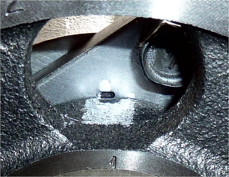

The way to check timing chain stretch is to get the engine at Top Dead Centre (TDC)... usually the damper pulley degree marking is fine for finding TDC.
Then look through the cam sprocket to see where the triangle aligns with the dimple in the fixed plate.
Here is a close-up:

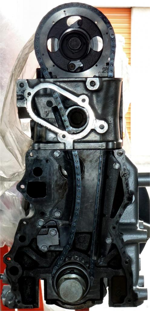

And the full monty:
Forget about the shiny links. These are used for installing a new timing chain and are typically only seen aligning then (unless you are lucky). They do line up but it occurs every xxx revolutions... it is sort of like looking at the moon and every now and then things are aligned and you see an eclipse.
Here is a close-up:

And the full monty:

Yeah, we did that and the groove in the fixed plate was just to the right of the notch, like the manual said. We even checked for stretched chain by hand cranking until the rotor started to turn, marked and then cranked in the opposite direction until the rotor started to move. It was only 1/4" which is less than 5 degrees, and from what I've read, is acceptable.
My only concern was if it is "Normal" for the slack side (driver's side) of the chain to slap the guide when you have the valve cover off and stop cranking the engine at short intervals, as in trying to adjust the valves?
