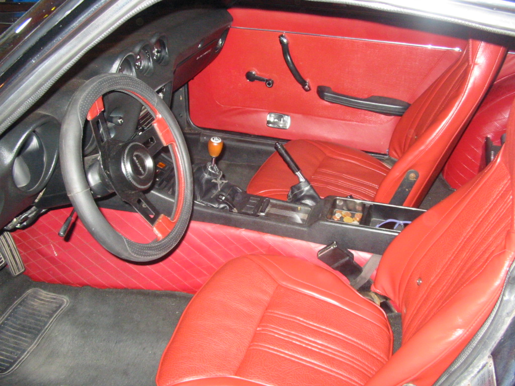

My leathers are installed. My upholstery guy asked what I paid for them (~$375 +/-) and he said that he couldn't even source the leather for that amount let alone produce a completed set for that. He rated the leather a 6.5 out of 10 noting it was a bit thin for automotive use. He was impressed that even the piping was leather wrapped but had to remove "the tail section" of the seat backs and stitch in more substantial material. This was the part that the hog rings secure to and he felt that it was a bit too thin / weak to be durable over the long haul and was not quite long enough.
All in all it was a good product for a good price. Still working on photos....
I purchase all the seat components from Les, and have completed one seat. So far is lookd pretty good, though there is a little wrinkle down the seat back. I need to replace support strap, since the stuff I used to fix it the first time seems to crack with age. What I used was similar to the original but not quite as thick nor covered in nylon.
Heat them up carefully but hot and smack the wrinkles with the back of a large wooden spoon-Here we just put them in the sun for a little while-the wrinkles should dissipate, the materiel just needs to find its groove. These guys have been making replacement upholstery for the Z32 crowd for some time
