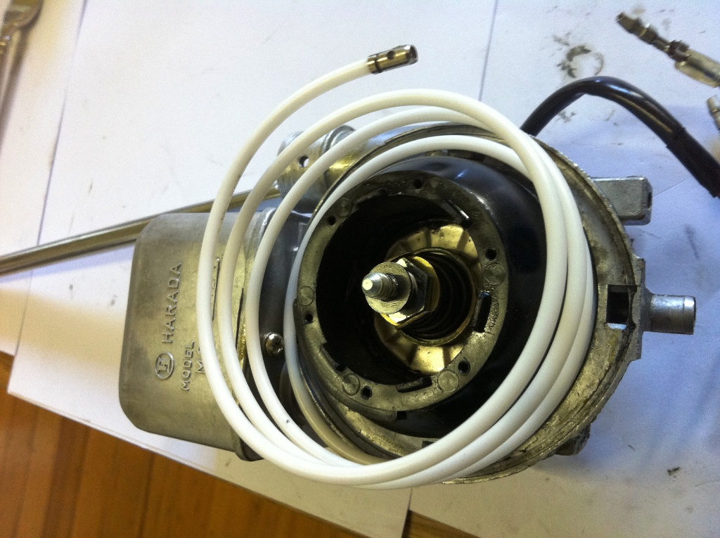

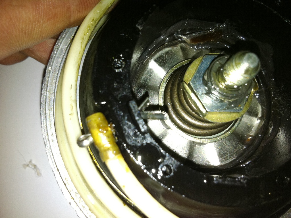

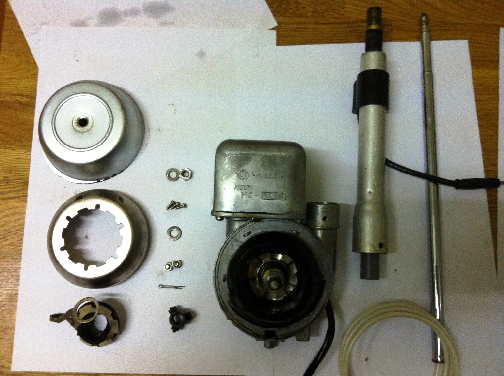

I know the antenna mast has been covered in many threads but I have a question that is probably to simple to mention and I do not want to get it wrong because these things are irreplaceable. I want to know what stops the aerial mast when it is in the fully extended or retracted position. The end is connected to the drum using a splitpin, if the winder keeps going then would the plastic cord not snap or is it strong enough to stop the drum from turning?
Like most people my mast has snapped some time back on my 1970 240z. I pulled it from the car to replace the mast with an exact NOS replacement (on Ebay about 5 years ago if your wondering). The motor in the antenna is pristine, no dust or dirt and looks almost new. I removed the old broken mast and aerial. I have then threaded the new mast into the guide and around the drum, but the hole for the split pin which holds the end of the mast to the drum is in the wrong location from where I last stopped the winder. Therefore should I fully extend the aerial and simply connect the end where the splitpin is currently located and let the winder do the rest or wind it to a set location and then connect the mast? Hope this makes sense.

it is my opinion that the whole reel spool is driven by a worm gear connected to the antenna spool by gears and plates that act like a slip clutch.
When lubed and installed properly with the correct tension on that rather large spring on the center threaded spool post, the antenna mast should extend and retract to its physical limits protected by this slip clutch arrangement of plates and gears. As long as you don't incorrectly adjust, or change, that
springs tension, the mast should work as intended.
