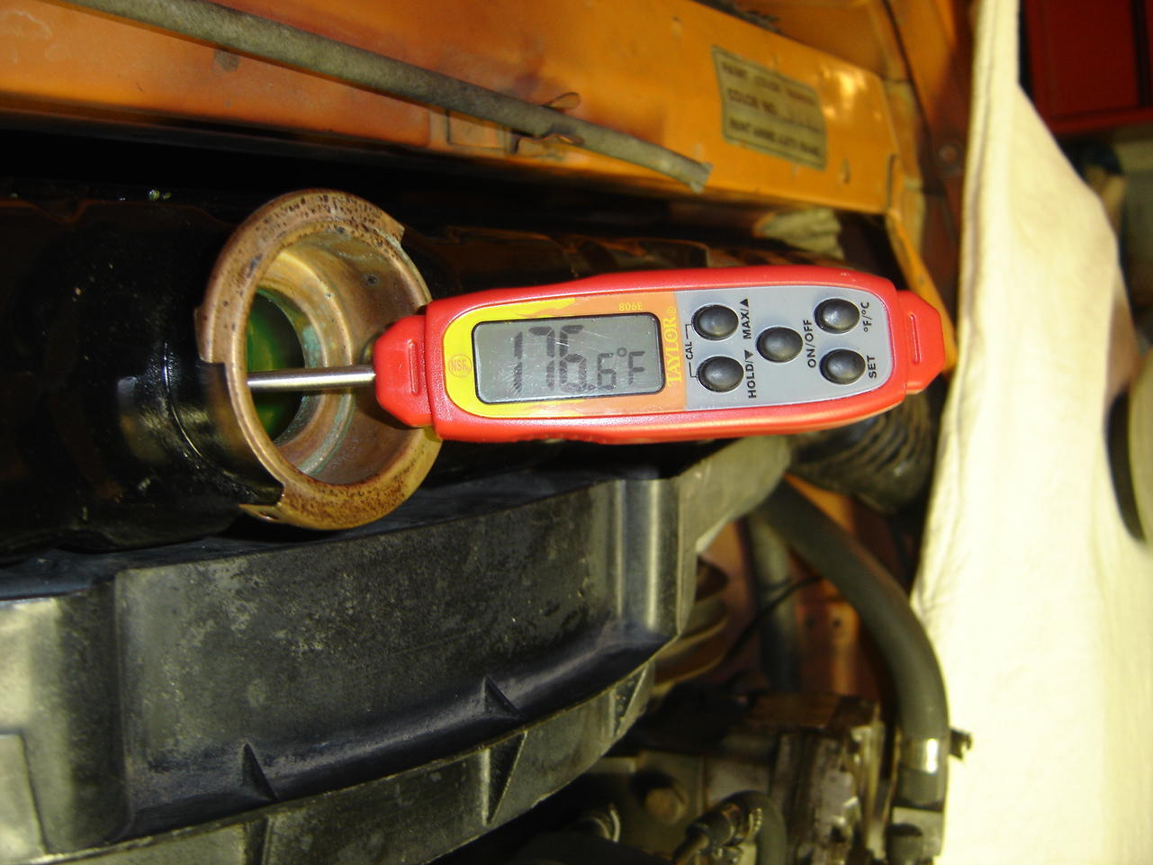

Try a digital thermometer in the radiator while it's parked, no air flow other than the fan. That is like traffic jams I would think. Mine runs at 175 farenheit with the thermostat open and coolant flowing.

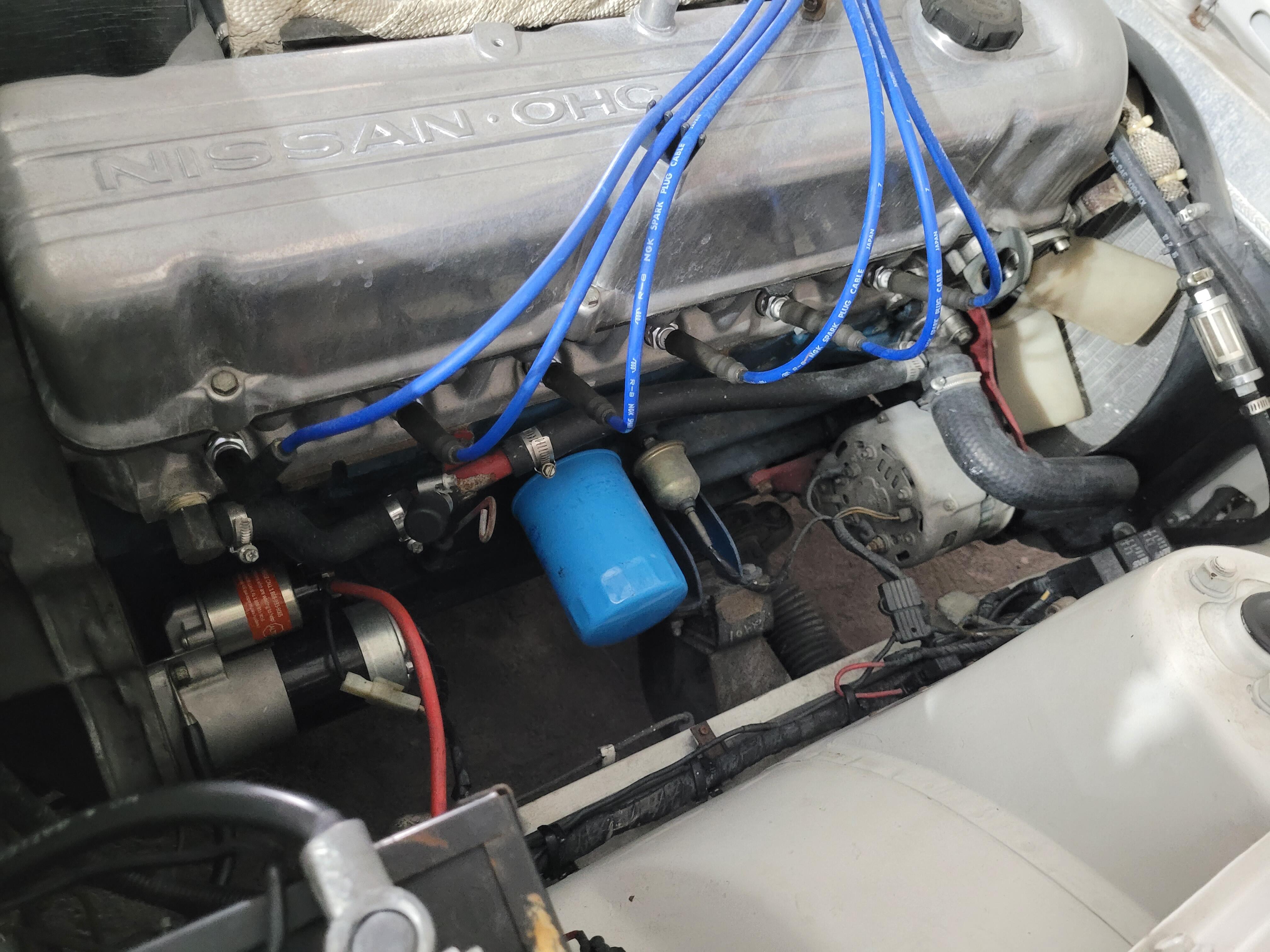

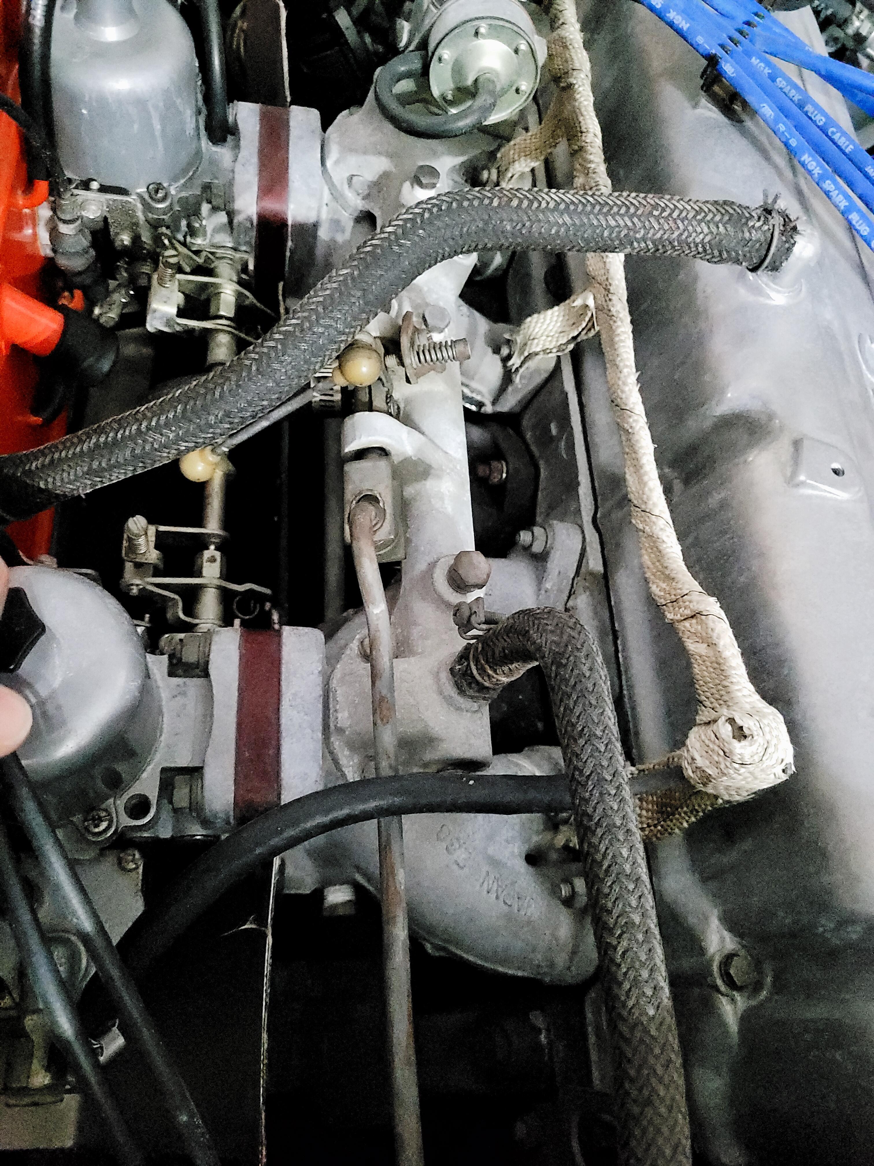

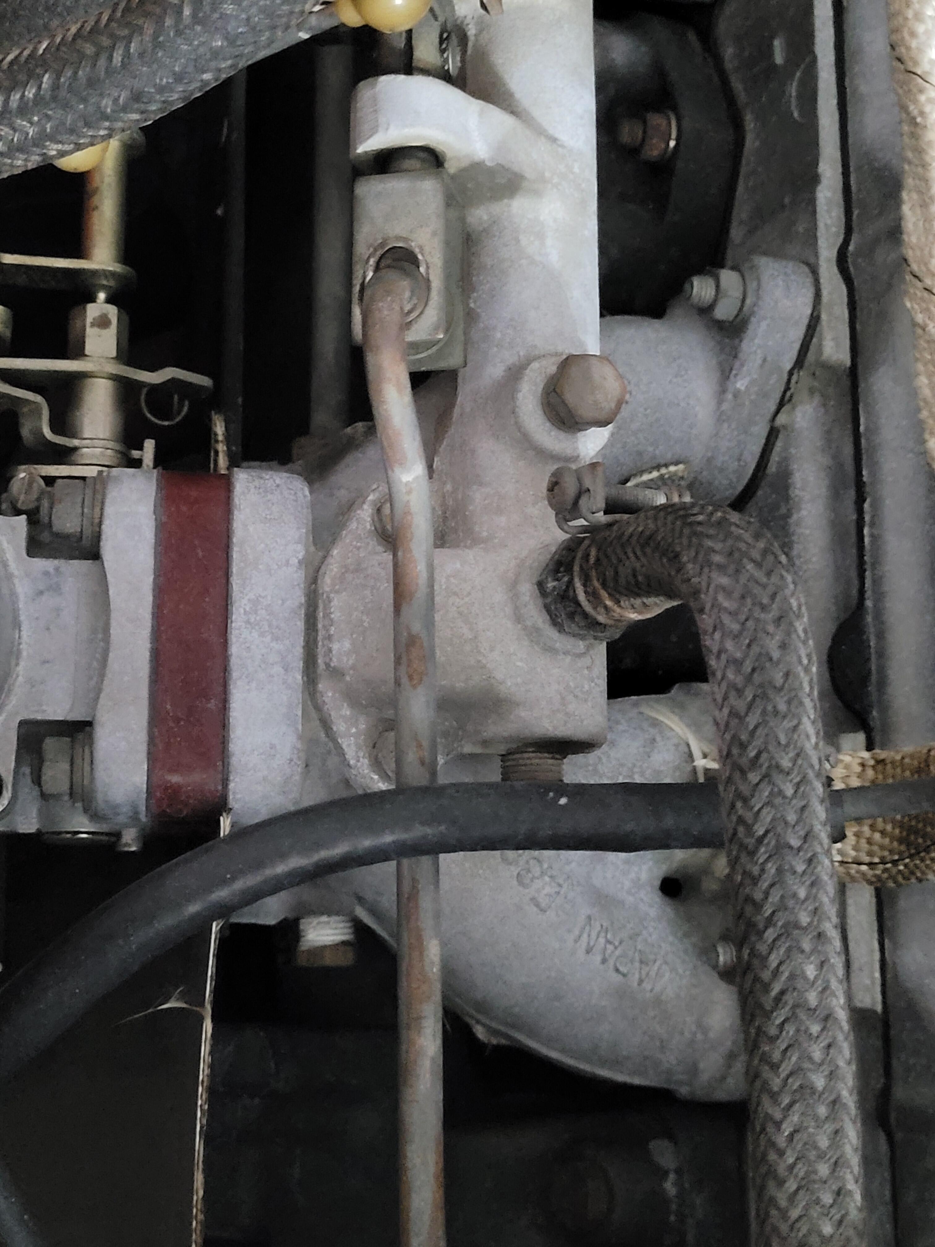

Well i do remember  shutting the water flow passage that runs on the back of both carbs by removing the intake manifold valve to reduce any kind of heat. My car also has the antibackfire / smog emmission system removed. Any recommendations on how to tackle this misfire caused by overheat when coming out from traffic jams?
The last photo looks like your heater core is bypassed? I’ve read about bypassing it and that it’s better to plug the fitting at the back of the block rather than looping it. I guess this is how the factory heater core works (stopping flow, not rerouting). Perhaps this could help?
