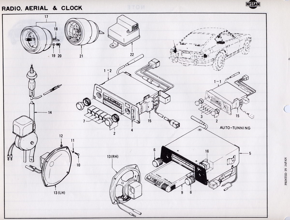

Just to clarify what I'm talking about, mounts for speakers were designed and engineered into both left and right sides, and the perforations for the speakers ( as opposed to the higher up and further forward perforations for the quarter panel vents ) were on both sides accordingly.
From the attached factory parts list illustration:
KEY NO. 13
27340-E4125 KIT-SPEAKER ( RADIO AM 5 BUTTAN [sic])
29240-E4225 KIT-SPEAKER RH ( AM 8TR STEREO )
29240-E4125 KIT-SPEAKER LH ( AM 8TR STEREO )
The perforations near the quarter windows are for the vents under the Z emblems, not speakers. No speakers were ever offered there.
And just to clarify what I'm talking about... I'm talking about the perforations below the quarter windows on both sides right behind the seats.
The ones that are right on top of the speakers that mount there. Page BE-5 of the 77 FSM:
It's looking like earlier years didn't put speakers there, but later years clearly did. I'm out of town, but I'll snap some pics when I get a chance.
Correct, no speakers there in any 240Z.
Right. That's what I posted that I found in the FSM's as well. But it's not just the 240... The 260Z also had a speaker back by the antenna, as did the first two years of the 280Z.
But what I'm talking about are the models that DID have the speaker locations below the quarter windows right behind the seats and have perfs in the trim panels for the speakers. That's what I found on mine.
I'm pretty sure that we're both saying the same thing, but you threw me a little when you said that "no speakers were ever offered there".
There were most definately speakers offered there... But not until 1977. We're all saying the same thing, right? :classic:
