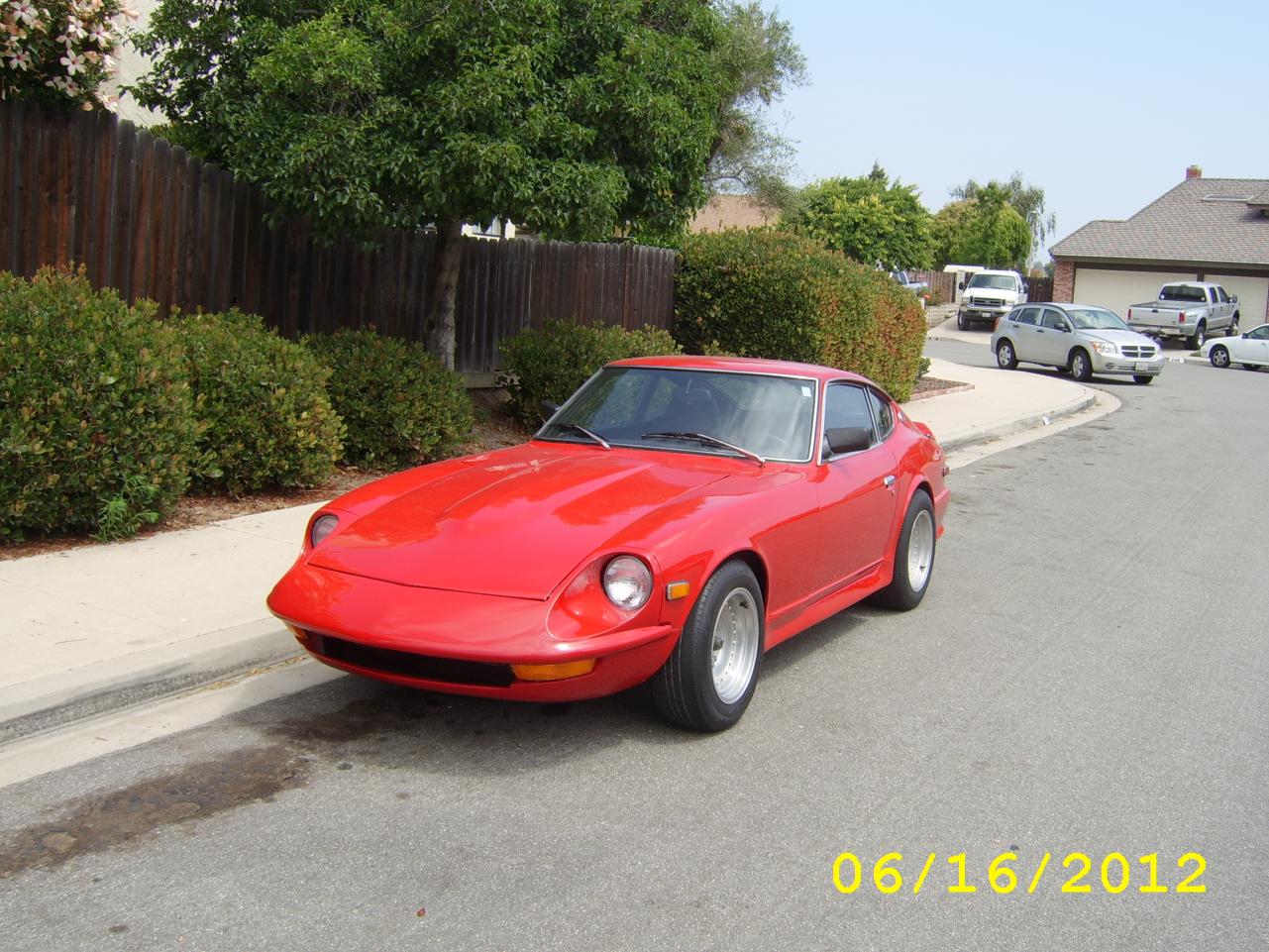

I currently have a set of "centerline" 15" that look pretty good. The problem is that previously I had flares on the fenders & the wheels fit fine. I got rid if the flares and now the centerlines are a little too wide & will hit the fender on bumps.

I retired & decided to restore the Z but without the flares. I had previously replaced the factory 14" deep dish mags with 15" Centerlines. They fit well with the flares. However I decided to go with a more stock look. My body man replaced the front fenders & rear quarters. The centerlines now have the same problem you describe.

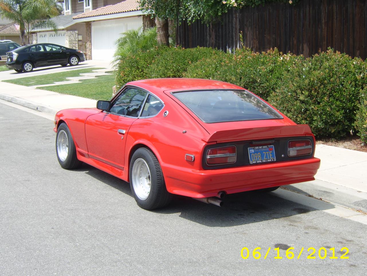

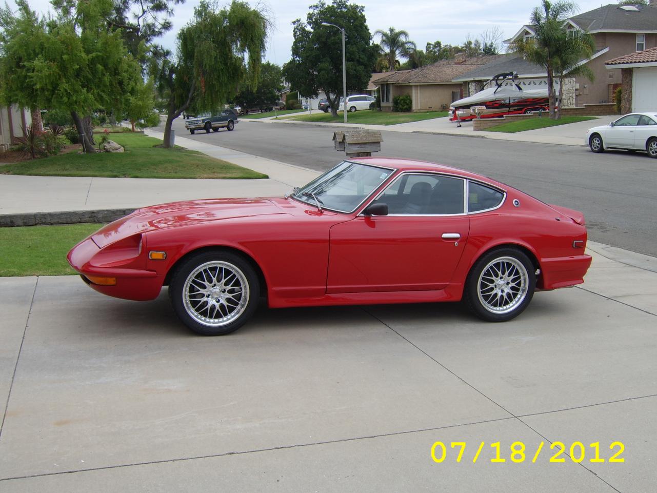

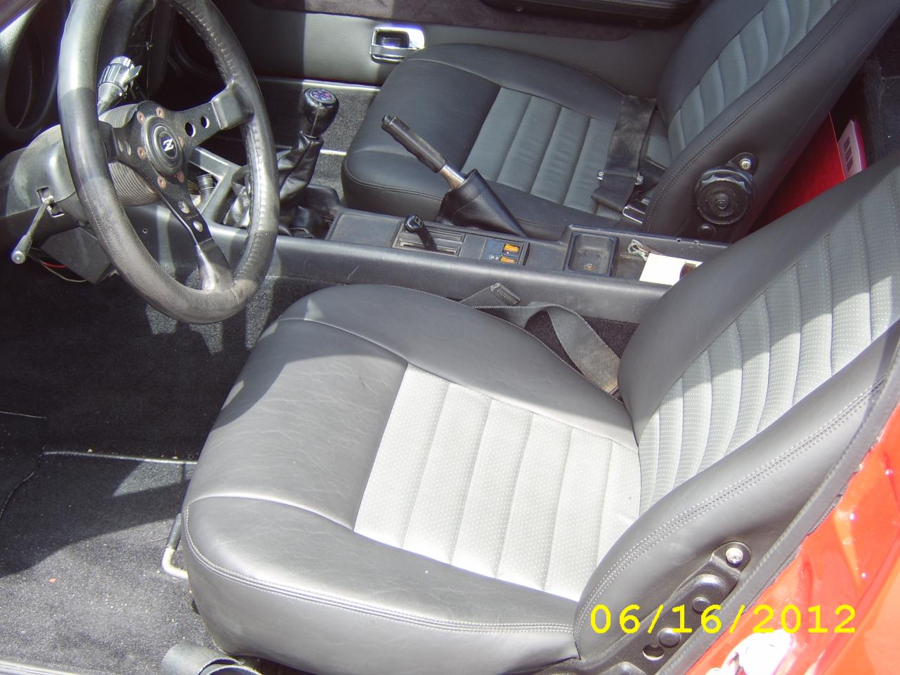

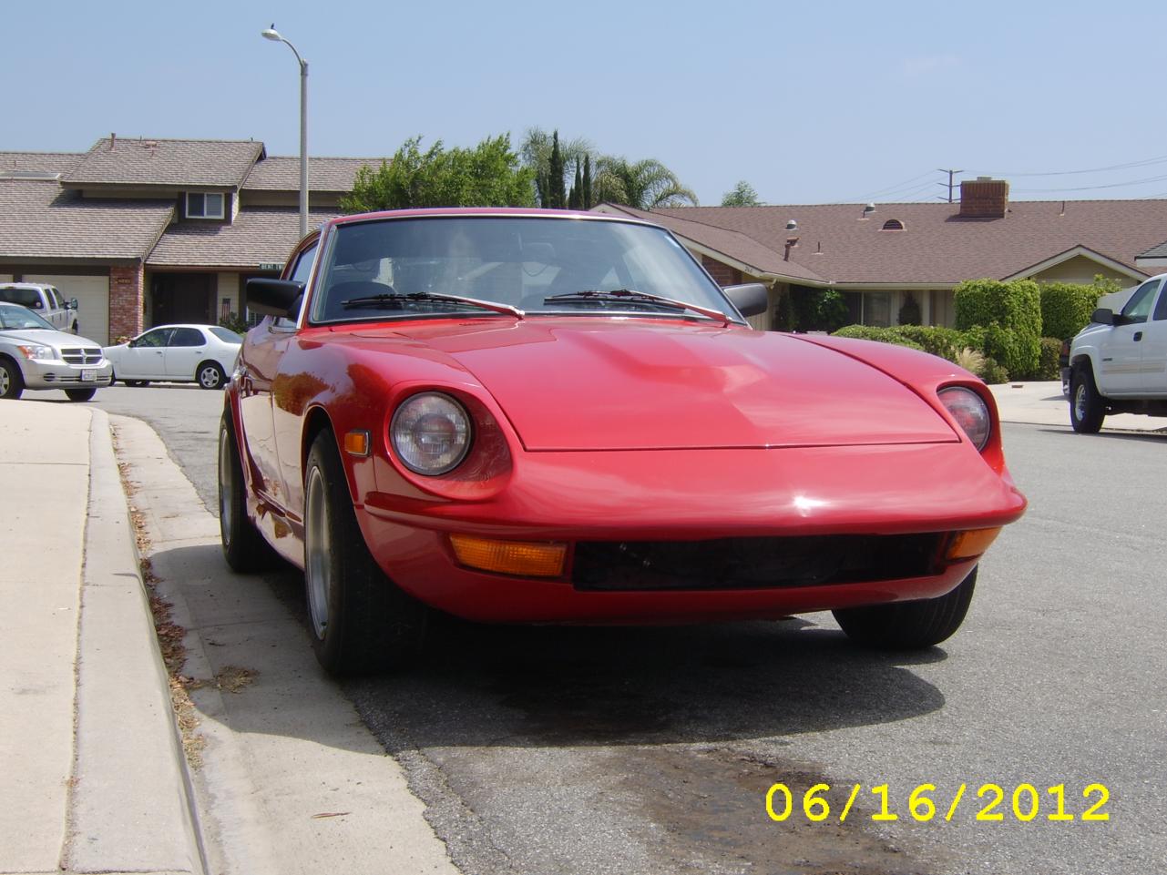

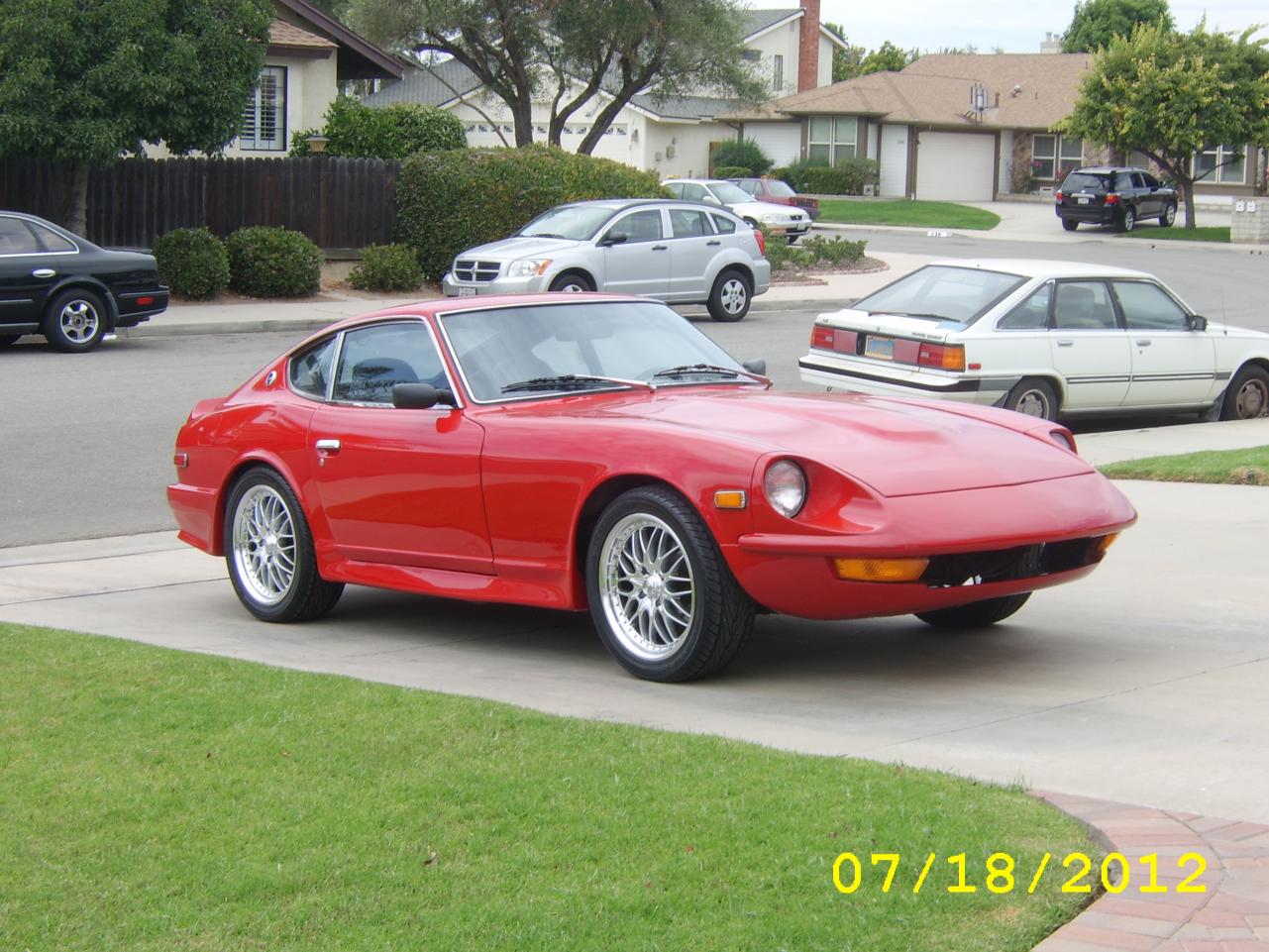

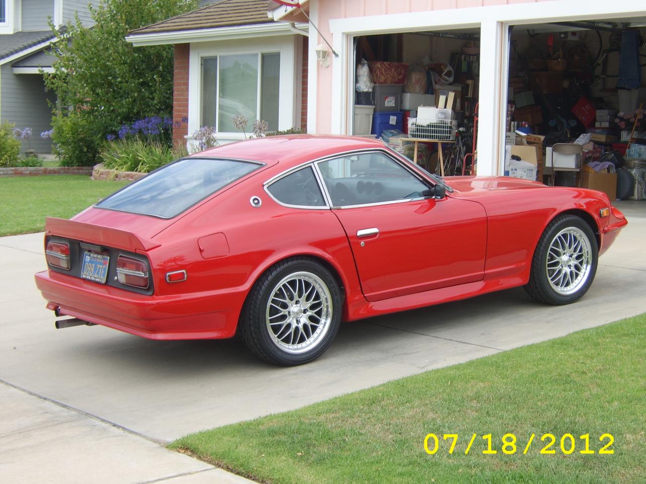

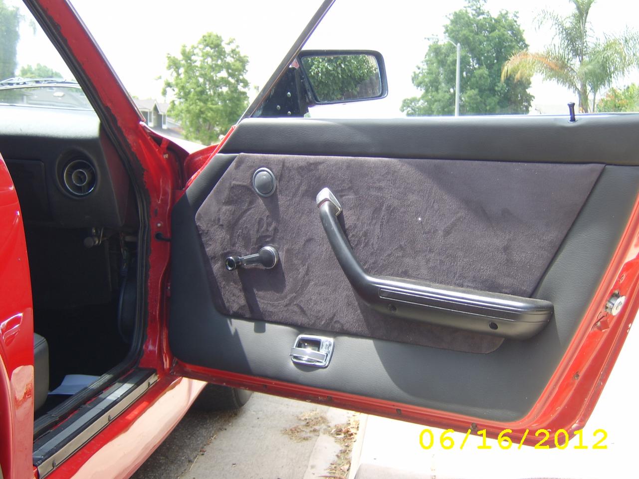

There should be 4 pictures here.
I wanted to show the door panel I got from pete robinson as they are beautiful.
Incedently I will be selling these centerline "lookalike" wheels if anyone is interested.
https://www.classiczcars.com/topic/43783-wheels/#findComment-395633

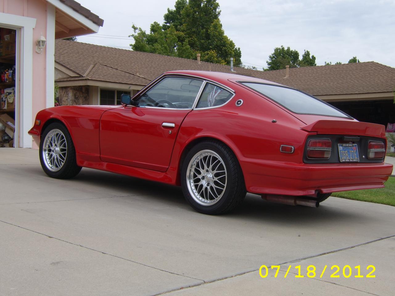

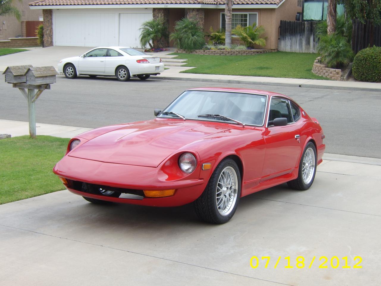

I got the Konigs that don't require any spacers/mods to fit. I think they look great.
I'm very happy to say thay don't have any clearance problems either.
I would like to sell the centerlines (8" x 15") if anyone is interested.
