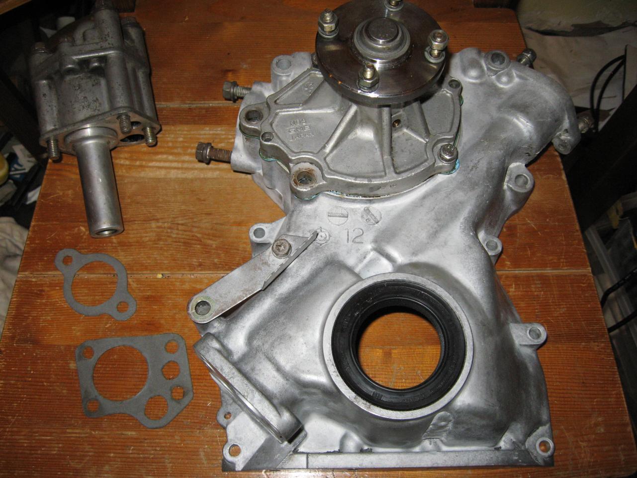

Oh back to the Z, I put in the front seal, no big deal, a little oil to help fitting it in. The Timing kit I got from MSA only came with the two front cover gaskets, So all other gaskets I needed I tried to source locally. Not to much luck, but I did at least find the water pump gasket. I find it absurd to pay 7.99 shipping for a 49 cent gasket and have to wait for two days for it to arrive. So for the coolant inlet and oil pump gaskets I cut out my own.
I cleaned more parts and bolts and installed the water pump on the front cover.
I hope to have the front cover installed tomorrow.

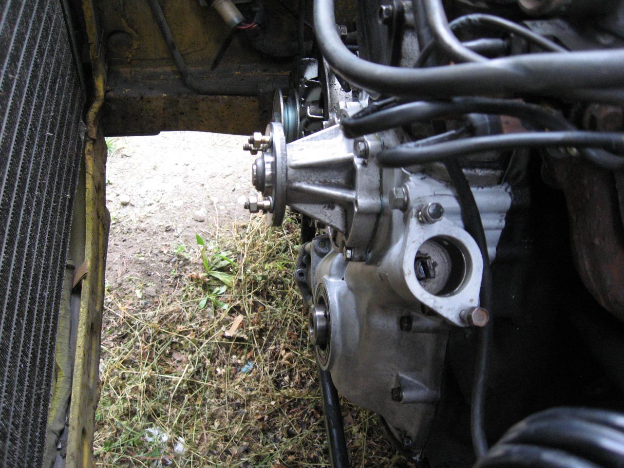

I want My Z back running. After work today I put the front cover back on, the oil pump, crank pully and the AC pump. The AC pump was a PITA.
