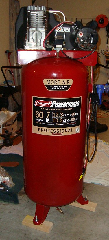

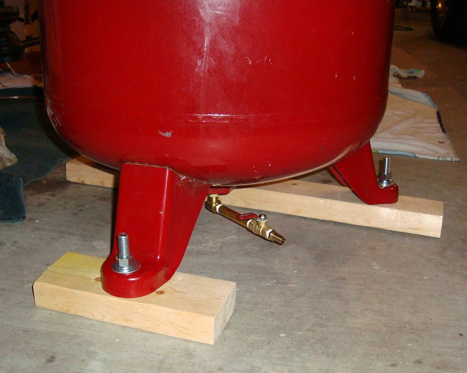

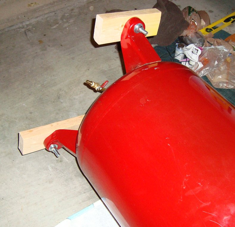

Congrats on your new purchase! A 60 gallon is a good for all around home garage use. As said above it won't run anything for too long without having to let the compressor catch. The factory drain is probably directly on the bottom and is pretty useless. I picked up my compressor on CL around a year ago for a song too, had two 220v plugs run in my garage, made some feet for it out of scrap 2x4's, and modified the drain valve using plumbing parts from home depot. You can make one as fancy as you want but for me this works really well.

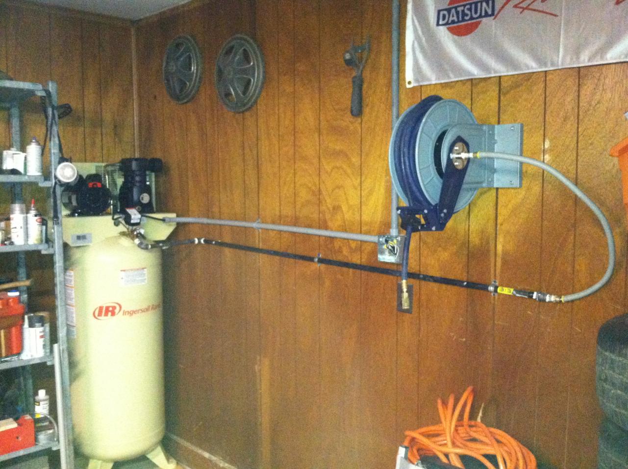

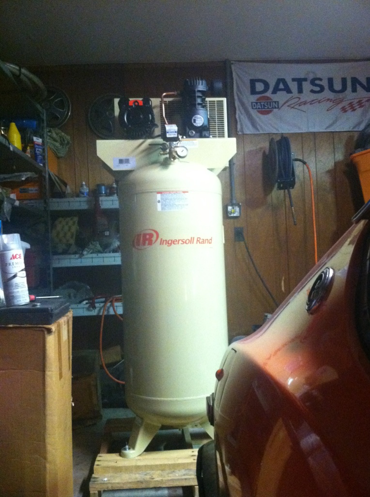

Looks good. I've got to get a line dryer and filter but otherwise its installed and looks pretty sharp. It works great. Ive had all kinds of air tools for years but never able to fully use them and man am I happy to hear that cut off tool run constant.
I like that. My Porter Cable 60 gallon compressor has the original drain valve and it's a pain to get to and operate. I might have to upgrade it to a 1/4 turn ball valve out in the open like yours.
Mike, what ever you do don't sucked into buying an inline oiler, (they sold me one) keep it dry and clean. A drop of oil down the input to the tool will keep the tool working fine. When you start prepping for paint that's when the lack of inline oiler realy
pays off. You'll be very glad you never contaminated your air hose.

Some suggestions. Looking at the picture - it looks like you used 1/2" black iron pipe - Yes/No?
The line from the compressor shut off valve to the wall - if it isn't already - should be rubber/flexible, with a quick disconnect on one end. When you get a dryer {aka water separator} / filter, you'll want to add an air pressure regulator to the line - and you can mount them on the wall just before the line to your hose reel.{water vapor will condense in the iron pipe}.
Most air tools are rated at 90psi - and you don't want to over feed them. It just drains your supply more quickly and doesn't gain any power at the tool. It can also wear them out faster.
The Milton 1108 1/2" Filter and Regulator Duo is a reasonably priced - higher quality unit. I'd stay away from the less expensive IR units sold by HF and Northern Tool.
Is the junction box - there for a Quick Electrical Disconnect?

I did use black pipe, its code here. Also that is a junction box, I forgot to buy a cover plate at lowes this weekend but there is also a twist lock plug to disconnect it if needed (also code here). I appreciate the info on the line dryer. I havn't bought one because the price gaps are so large I wanted to research more but I will look into the Milton unit. I installed a fifth wheel hitch in my dads F250 this weekend and boy did it make it easy cutting that bed having a good air supply.
