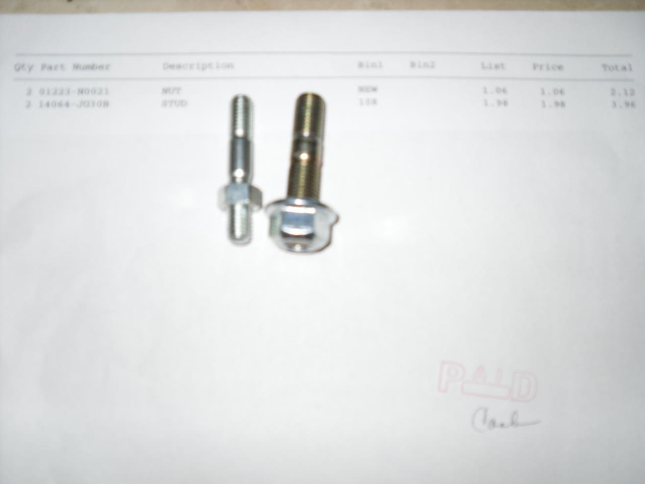

[ATTACH=CONFIG]62858[/ATTACH]
I used those too. Seems a lot more secure.
Those are the ones. although when put side to side with the stock nissan ones the titan studs protruded a bit longer on the side that threaded into the head (unthreaded bit at the end). I didn;t want to drill any further into the head to put these on because i am unsure about how much material is there in the head so i chopped this extra bit off the studs.
also of note to anyone doing this, the thread on the end going into the head is 10 x 1.5, and the thread that takes the out of round nut is 10 x 1.25. You will need a couple 10 x 1.25 nuts to torque these studs down as you dont want to use the locking nut for that.
I am tempted to do all the studs with these, but I think doing the ends and the middle stud (was a little stripped on mine) would be fine to sure things up better.
These studs can also be tightened up a bit more like the M10 intake studs on top.
