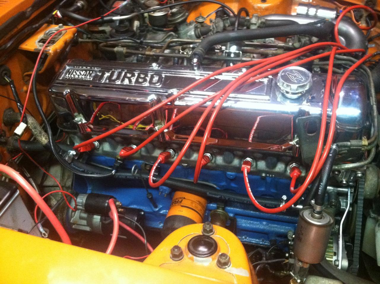

HAHAHA you are right. I'm in pretty deep. Willwoods are on the list. Just don't know if I can swallow the 200 extra for red. Come on really? $200 extra. Thats just not right. The springs are just the eibach kit. They say they don't lower the height on the 240 but it does sit lower in the front now. I havn't started with the rear yet. I'm installing an R200 so i'll do it while i'm changing the rear diff. Here is what I was entertaining myself with today. Looks pretty good. I'm in the midst of re doing some wiring with shielded so wiring is a mess. This car will be pretty nice when its done. I don't know how the T5 will feel but shifting it just out of the car it feels amazing. I can't wait to see. Thats a really nice Z madkaw. I noticed you say you are running the subi LSD. What axles and companion flanges did you use?
