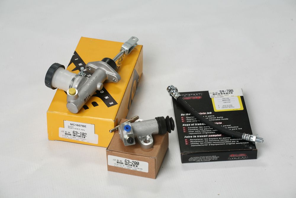

I'm with Bruce - I've never had long-term success rebuilding clutch hydraulics. By the time they fail, the cylinder bores are generally trash.
I'd also recommend not trying to do only a piece at a time. Experience has also shown me that putting a nice, new master in with an old slave will generally lead to failure of the slave in short order. I'd recommend getting a new master, new slave, and a new pressure hose all at once. Do it once and be done with it.
Here's hoping these are not remanufactured hydraulics with old problems left inside.
Don't forget your copper crush washer on the slave to hose connection! There's one in the box, isn't there? You can always use the old one if need be, shame if its not new.

I've seen it recommended and I've done it myself - take the cylinders apart before installation and make sure there's no grit left inside from manufacturing. If you run your finger inside and it comes out gray and sparkly, rinse the moving parts with brake fluid before putting back together. I had a slave cylinder fail in about 6 months and the replacement from the guarantee (poor quality replacement parts for life!) was full of honing grit. It's been on for about a year with no problems. I just had to finish the factory's job for them.
