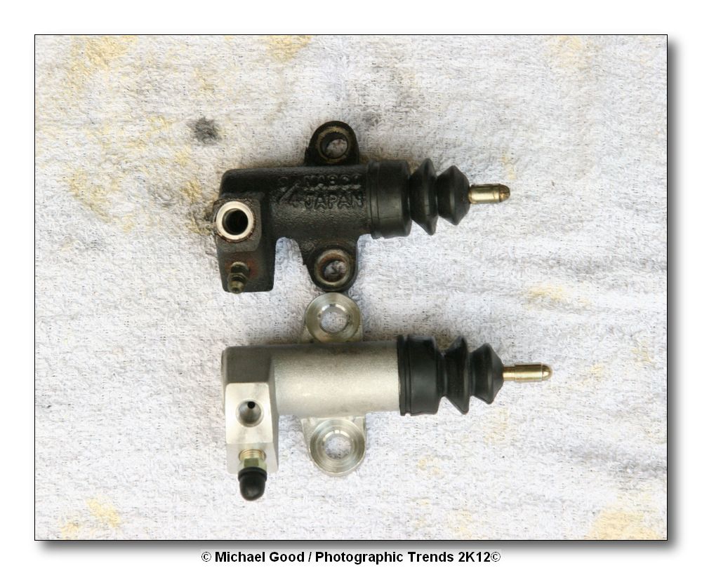

Hmmm....not sure what this means but I should add that I did not take my master cylinder apart. Only the slave. Maybe the master cylinder is problematic.

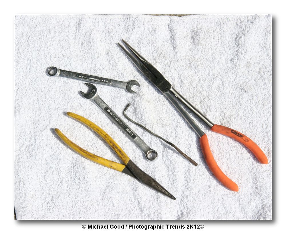

I speak of installation. Had to use long needle-nose pliers to even get to the clevis and cotter pin. Very little space to reach the fasteners on the interior side as well.
Taking the seat out helps with installation. I've used a hook shaped wire to remove the clevis pin, then I found a long set of needle nose plyers, they help in working the solid pin in and out of the clevis. A set of long right angle needle nose helped in putting the clevis pin back into that little hole, and to push the pin in or out of the clevis. In other words, its like watch & clock making, use the tools as your fingers. :)

Just wanted to point out that you probably don't need the copper washer, the way new slaves are designed is that they taper toward the end so that the hose you screw in fits exactly in place. a washer may end up causing a leak.
Also, you don't need to go to a specialty store for your slave or the hose that you screw into it. I got mine a month ago at my local Napa (I also replaced the clutch at the same time, but that I got online), and I'm sure that most places have similar products stocked. Just bring in the old and they should be able to figure it out if they are a good parts place.
