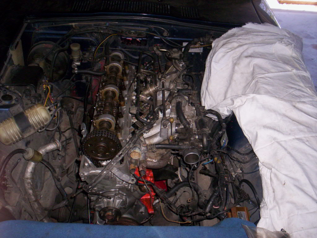

Ok, all the manifold are on, and someof the wiring is done.
Stuck on a couple of things....first of all, which injector leads go to which injector :cross-eye Anyone have a wire color/injector cross reference ?
My biggest concern is that I can't find the fuel injection relay which is prevalent in the 280z 'EFI bible'. I've been looking in 280ZX's for it and cant find it at all. Does anyone have a picture or something ?

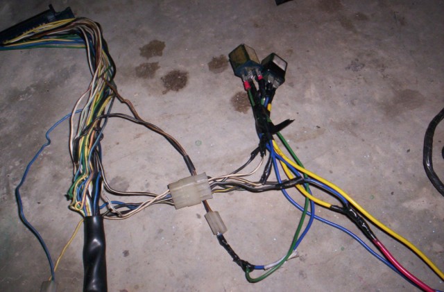

Here are a couple of pics, First one is where Im at, second one shows wiring which is supposed to hok up inside the car...I've got no idea what to though !
The L28 engine was ripped out of an R30 skyline (previous owner had replaced the L24), so Im not even sure if I have the L24E harness, or the L28 harness.

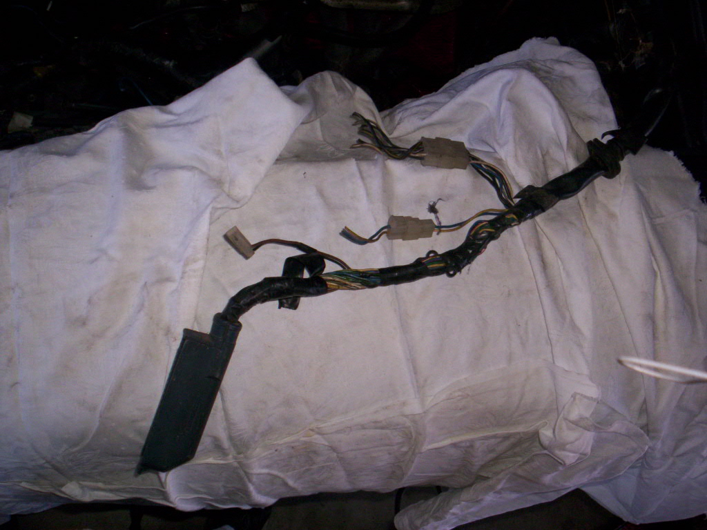

I'll check my loom tomorrow as I pulled it all without having to make too many cuts.
On the injector loom I did find numbers when I pulled back the sheaths, But that said I've been told that it doesn't matter as they all fire at once.

What you are up against are the differences between years of fuel injected Zs and 850/maximas. As to the Zs, the 75 - 77 280 is very similar. the fuel injection relay, (single relay) is located in the left side kick panel, at a height which places it behind the dash.
The 1978 280Z has an interim injection system. Three relays, all located under the black relay bracket, in front of the battery on the passenger side fender well. It is quite similar in function to a ZX.
The 280ZX also has multiple relays, but they are not all in the same place (from memory). I think one is on the right or passenger side fender wall in a recess in front of the battery and two others are on the drivers fender wall toward the front.
The 850 Sedan system is quite similar to the 75 - 77 280, (I used an 850 CPU in my 75 280 years ago). The maxima is close to the ZX, but I can't recall the relay locations.
In essense the the 78 280Z was a change over system, moving toward the ZX system, which had the 02 Sensor and other bells and whistles.
You must look for the relays, which match the harness (year and donor car) you are installing.

ecp48, thanks for that, my wiring should be a post 79 (no fi system sold here prior to that). Will have to take another closer look at the loom. from what I recall though, there was one relay on the loom, and no plugs for any more relays in the engine bay....

Based totally on hearsay (Lawyer term), when I was trying to figure out what I had after acquiring the 78 (I had a 76 and had previously owned a 75), a local tech told me that the 78 harness was used for only part of one year here, but was used until early 80 in OZ. If so, the harness would have 3 pigtails for a four pin relay on the passenger fenderwall. The relays mount behind the black bracket (large L shaped) in front of the battery. Two are the small (appx 1 - 1.25" square) base, one the 1 X 2 base. The latter may have five pins, I can't remember and my schematic is not at hand.
By the way, the fuel injection relay on the 75 - 77 was on a pigtail off of the FI wire loom near the ECU connector.

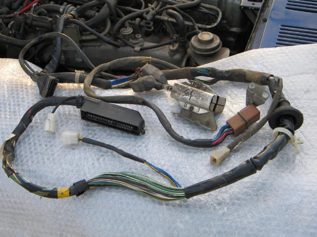

Here's a pic of my S1 280zx fi loom.
A rough idea of wires from ECU plug
single spade. -ve coil
3 spade. acc on ignition
+ve fuel pump
-ve fuel pump
2 spade. both +ve battery terminal
brown relay came from compartment near battery LHS
2 connectors go to 2 silver packs which control first 3 injector and last 3 injectors
flat black connector goes to airmeter
This is all just an educated guess at the moment, I haven't fired mine up yet!

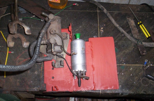

On another note, I have modified my std fuel pump bracket to accomodate a High pressure pump and a surge tank. Not sure if I will try cramming it all on the one side or if I will mount the surge and high pressure pump on either sides of the bracket. The photo has the std lift pump and the high pressure pump. Im yet to get my hands on the surge tank, but would like to keep it to around 600ml for size reasons (would this be big enough?).
