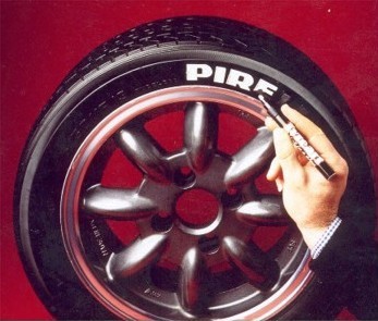

Then, go to your local tire supplier or Tire Rack on line and buy a white tire paint pen (yellow is also available) and paint the lettering on the best tire choice. I got my tire paint from the local Harley dealer for ~ $12.00, I had to go around the car with two coats the first time to get the coverage but once done it proved to be brilliant white and very durable. It also helps that you can touch up the lettering if you scuff it on a curb or pot hole. It also works on the white lettering and white walls for touch ups.

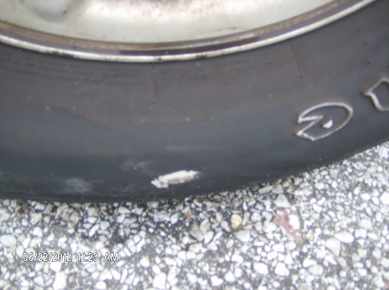

The way that tire companies made the raised white letters wasn't paint by the way. They are literally just like a whitewall tire. There is a thin layer of white "rubber" material molded into one sidewall. After the molding process they send the tire into a grinding machine (literally called a white sidewall grinder) to remove the outer black layer and expose the white materal underneath. At one time some companies would put the white materal into all tires of a particular size, and just not grind the tires that were ordered as blackwalls. Today since the white letters are out of style I doubt that anyone does that.
I have always heard, but have seen no factual evidence to support it, that whitewall tires, and tires with raised white letters were weaker than tires made without the whitewall material inside. Certainly the sidewall with the white material is thicker, which may degrade its heat dissipation capability. The white letter tires are also likely to be slightly heaver than a tire that does not contain the extra decorative material. I suspect that as the whitewall/ white lettering went out of style, the tire companies have nearly all decided to save a few $ per tire and just skip the whole process.

And everything Walter states RE the molded white lettering is correct, I will add that the white rubber is a very soft compound as well and is easily damaged.
But it is laid over the carcase and is not part of the functional workings of the tire itself, If you neglect the tire pressure (or even run the pressure low for comfort or drivability) and get into a hard corner, you could grind the black overlam off. Just one more reason to go with the paint.

I've heard of white letter paint. My only issue is, even with a steady hand, will the tires look good, or look like I painted the letters myself. Thanks for the advice. I think I will look for some examples online. This would definately make things less complicated.
Most tires have raised black letters. I believe that 5thhorsemann is suggesting that you highlight the existing lettering, not create your own. You could mask the edges of the lettering if necessary to produce a clean edge.
I would wager that if you took your time the letters would look fantastic. But you would need to find a tire with a thick raised lettering on the sidewall. Perhaps the Firestone Wide Oval, which is available in good 15" sizes still. From 5 feet away nobody is going to notice anything remotely not perfect. These are tires, not fine crystal. Even new tires have non perfect edges.
