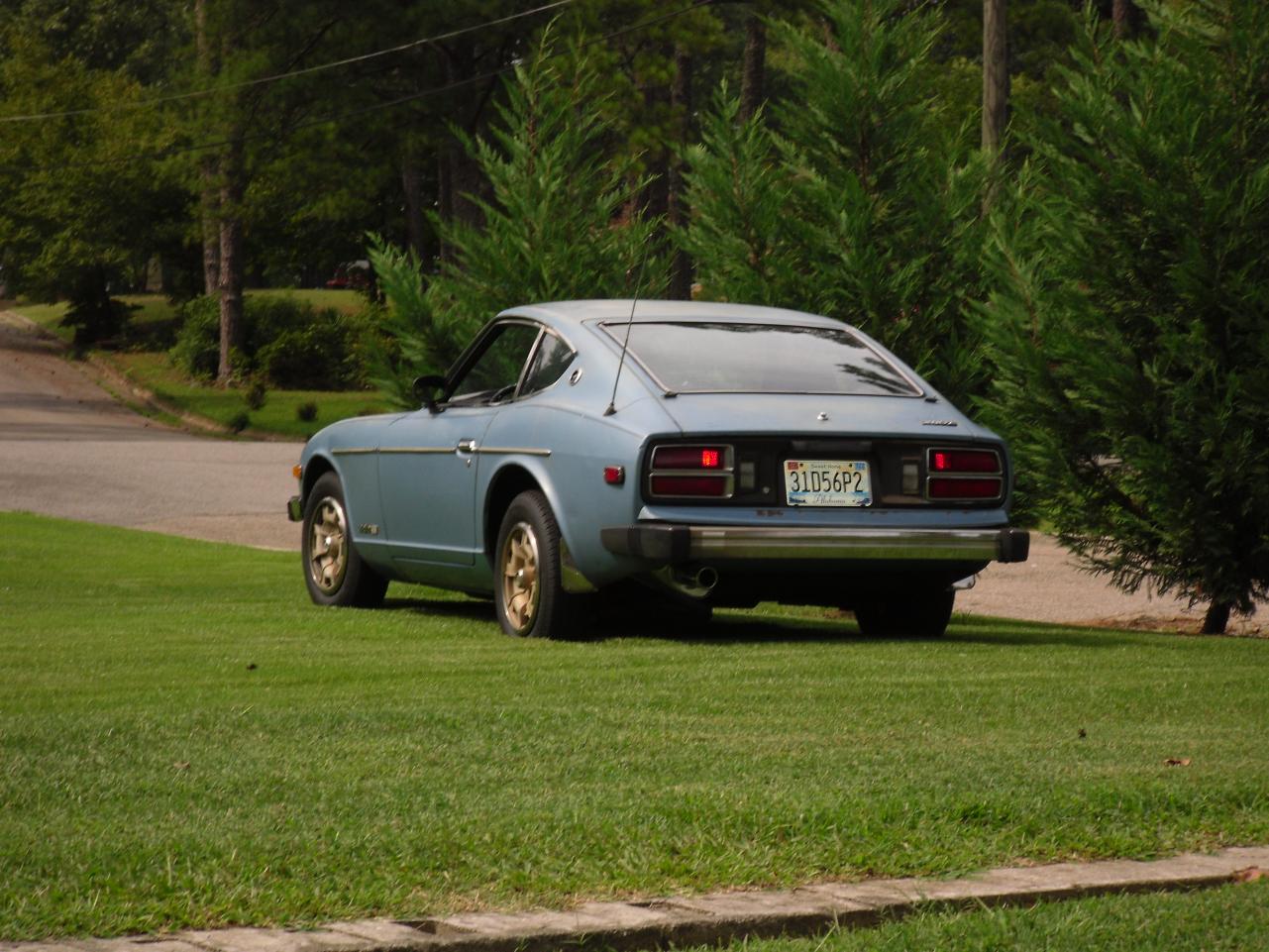

So here it is. I think eliminating the resonator was a mistake. Since this has an automatic transmission, I think the louder sound, sounds crappy. If this were a manual, it would sound great going through the gears. At least I can always add the resonator. Or maybe a manual transmission....Hmmmmmm.post-18334-14150820116884_thumb.jpg
