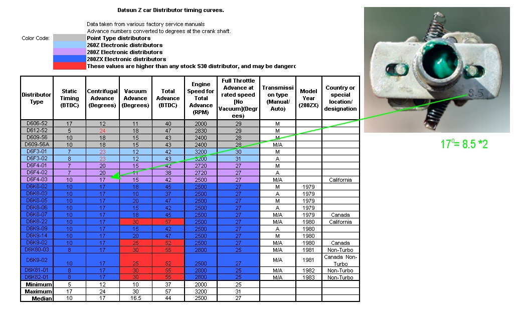

Other than single vs. dual points configuration, what is the difference between an AT and a MT distributor? I'm currently running a Petronix electronic ignition within my troubled MT distributor. I'm wondering if I can just pick up an AT distributor, pull the dual points out & put my Petronix in & be set. Has anyone attempted this?
The advance curves, vacuum and mechanical, are different among the numerous distributors that you could run on your engine. The advance specs are in the FSM if you want to compare, and somewhere on this forum there is a thread with a spreadsheet linked compiling most of the options out there.
