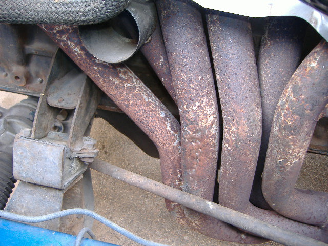

The headers on my car, ca 1980, have a piece of round metal tacked to them for this purpose, it is in the upper left by the braided hose. I don't use it and never took it off, but will when the headers get coated.
