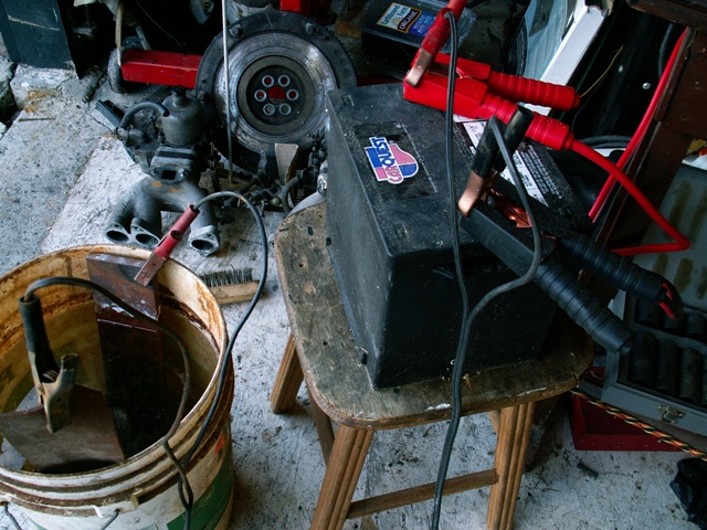

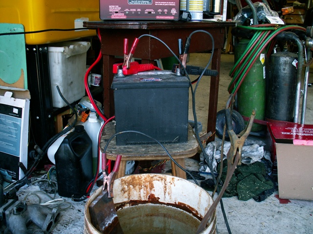

post-26437-1415082056329_thumb.jpgES, my set up isn't as elaborate as the guy in SteveJ's link but it does work well with time. You can follow his instructions or many similar ones on youtube and such.
I do not put my working piece (the part that is rusty and needs cleaning also called the cathode I think, NEG terminal) in the centre with the POS anode sacrificial steel all around it like the link, I put POS on one side of the bucket and NEG on the other side and start it up. Most of the cleaning action takes place on the side facing the POS anode but some rust comes off on the back side as well. I pull the work piece every hour or so and scrub it down with a wire brush, give it a half turn and return it to the bucket. I use washing soda but have used baking soda in a pinch and it worked well, but washing soda has the added benefit softening up any paint that might be on the work piece.
After having cleaned many many pieces this way over the years I can say that electrolysis isn't the cheapest way to clean rust off something, but it doesn't remove any exsisting good metal.
If I were restoring an old valuable artifact I would use electrolysis exclusively, for car parts, now I remove as much rust as possible with wire wheel or 3M rust wheels or any other mechanical means before I go to electrolysis to get the hard places to reach.

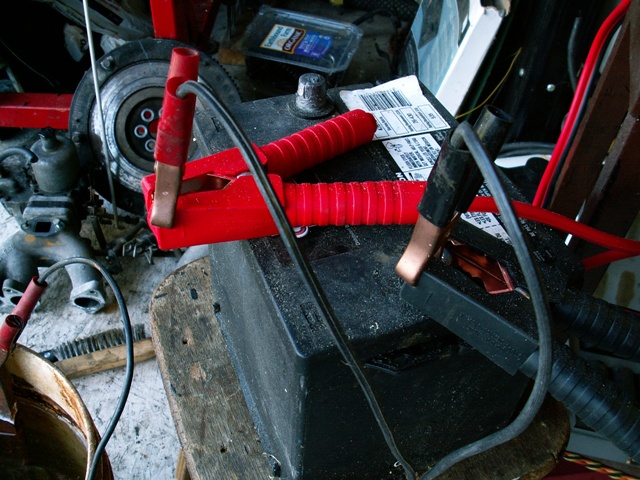

First pic is the whole set up, second is a close up and third is a reminder to disconnect the battery so it doesn't boil over. That last point is a big thanks to SteveJ.
Chris
