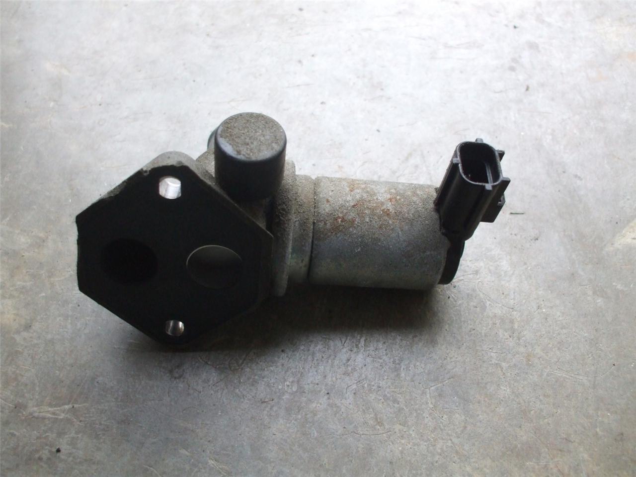

After quick search I found that the Fords have something similar, but I couldn't tell if it was a proportional thing or on-off, and you'd need to modify the intake, but it was dirt cheap ($30 new,) so you could get one at the JY easily (probably.) It's just not the flow-through design that thew L28 engines use (so we keep looking.)
Edited by TomoHawk
I found out the Ford units use a stepper motor, so it should be inherently proportional, if you can figure out how to get the motor to move the right amount..
Since the L28E is an electronically-controlled engine, it's more appropriate to use similar parts when upgrading. So far, it looks like the best thing is the original Bosch unit, so when you get a new one, get several. ;)
